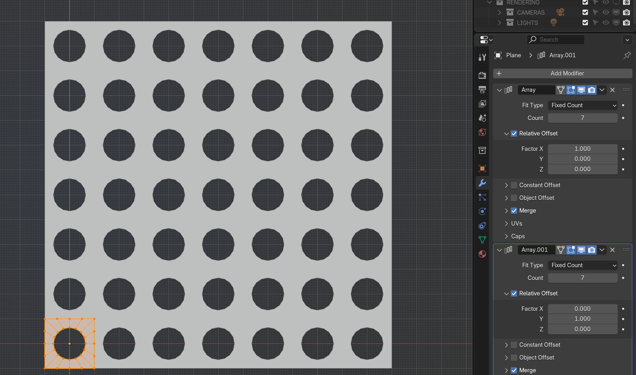

    As an alternative, you could also model 1 hole (easy with the Loop Tools Addon), Add Array Modifiers:

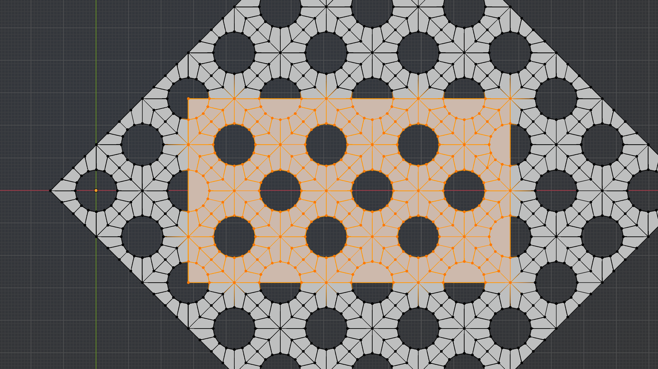

    In Object Mode Apply the Modifiers and Rotate the Object 45°. Maybe Fill in some Faces at the Edges and Delete what you don’t need (the inverse of what is Selected here):
