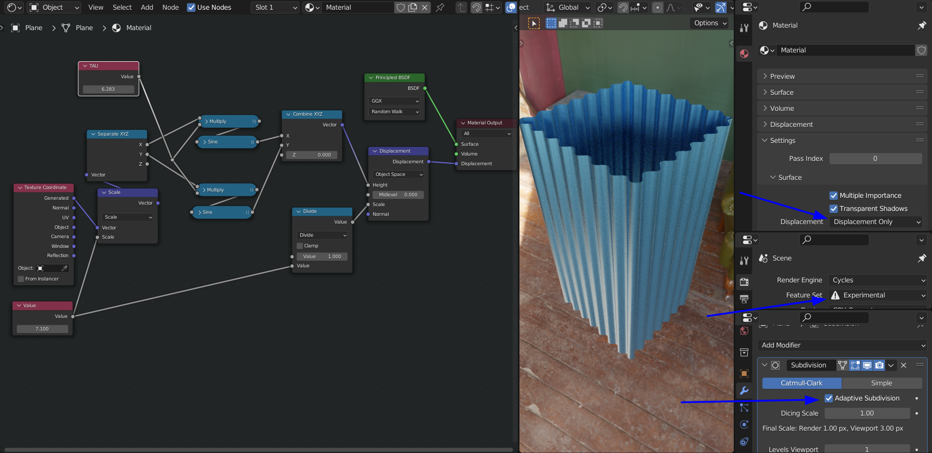

You can use Shader Nodes:
Cycles only and needs to be rendered.

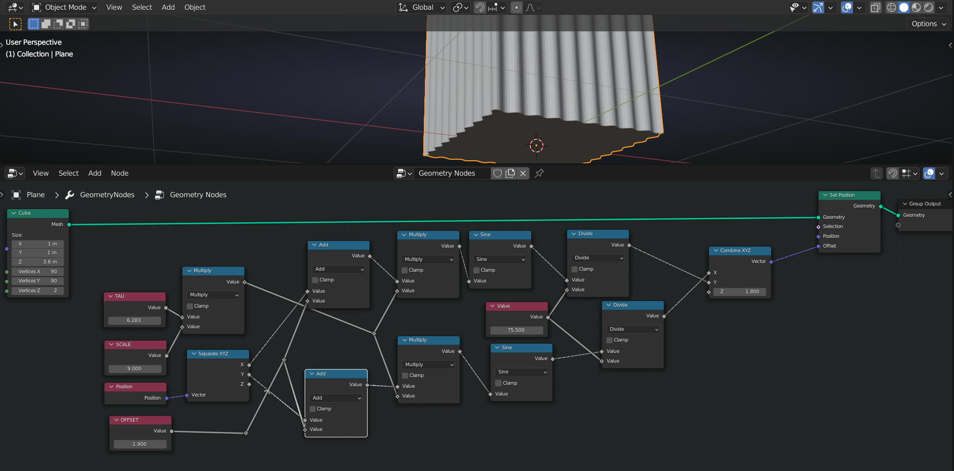

Or try something with Geometry Nodes, for instance:
A bit tricky to get the edges correct, but it works. You can also use two Wave Textures here, one in X- and the other in Y-direction.
