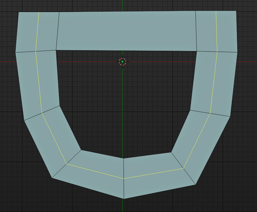

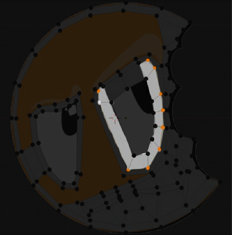

    Hey @geedee , good question! You’ll get more used to seeing which way loops go as you continue modeling. To expand on what @tomasplasil mentioned, here’s what your face loop looks like with all of the other areas faded away:

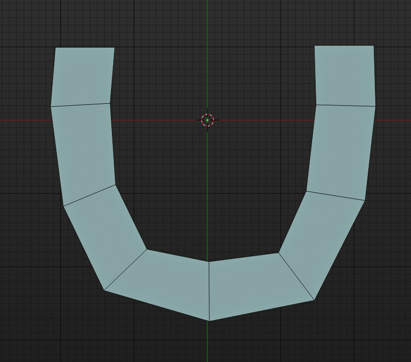

    You’ve essentially got a U shape:

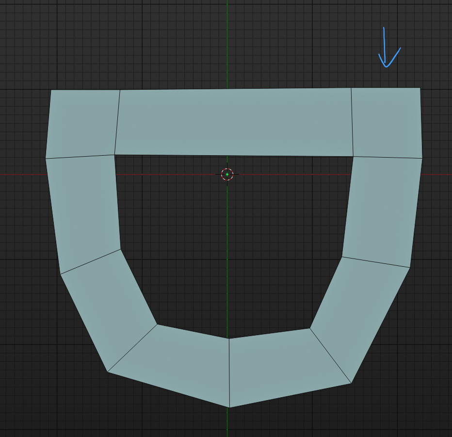

    Connecting the top faces won’t change the direction of the loops:

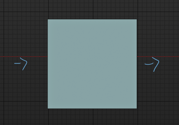

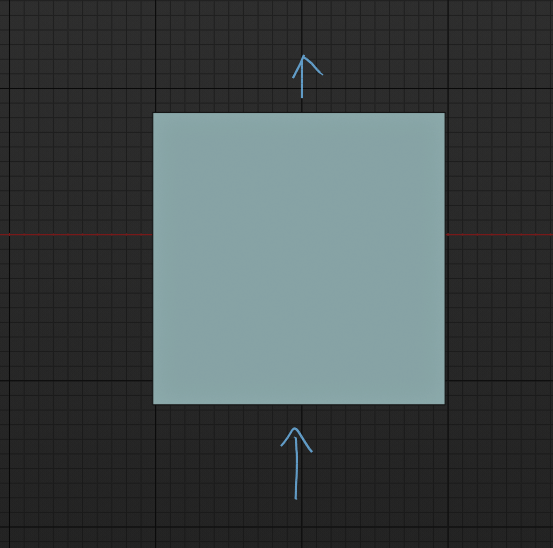

    Loops only go straight through a quad – in one side and out the other. There are two possibilities:

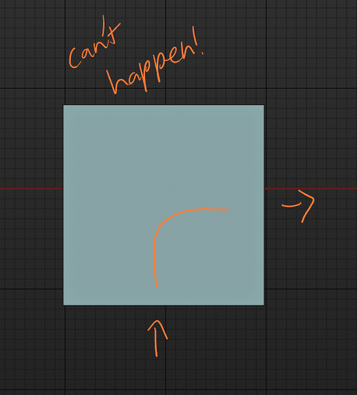

    But under no circumstances will it ever take a turn inside a quad:
    Always in one side and out the opposite side. To see why your eye isn’t forming a loop, trace imaginary arrows through each face, starting with this one:

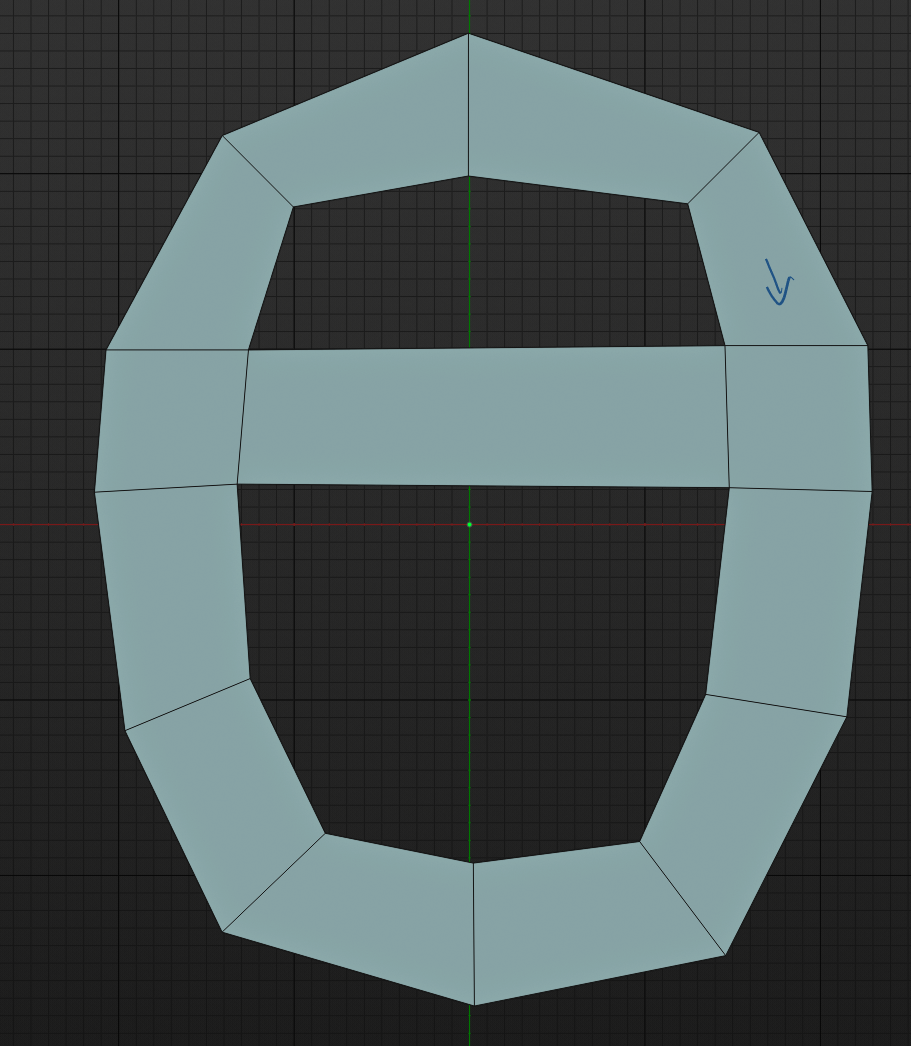

    Then, do that same exercise on this picture:
