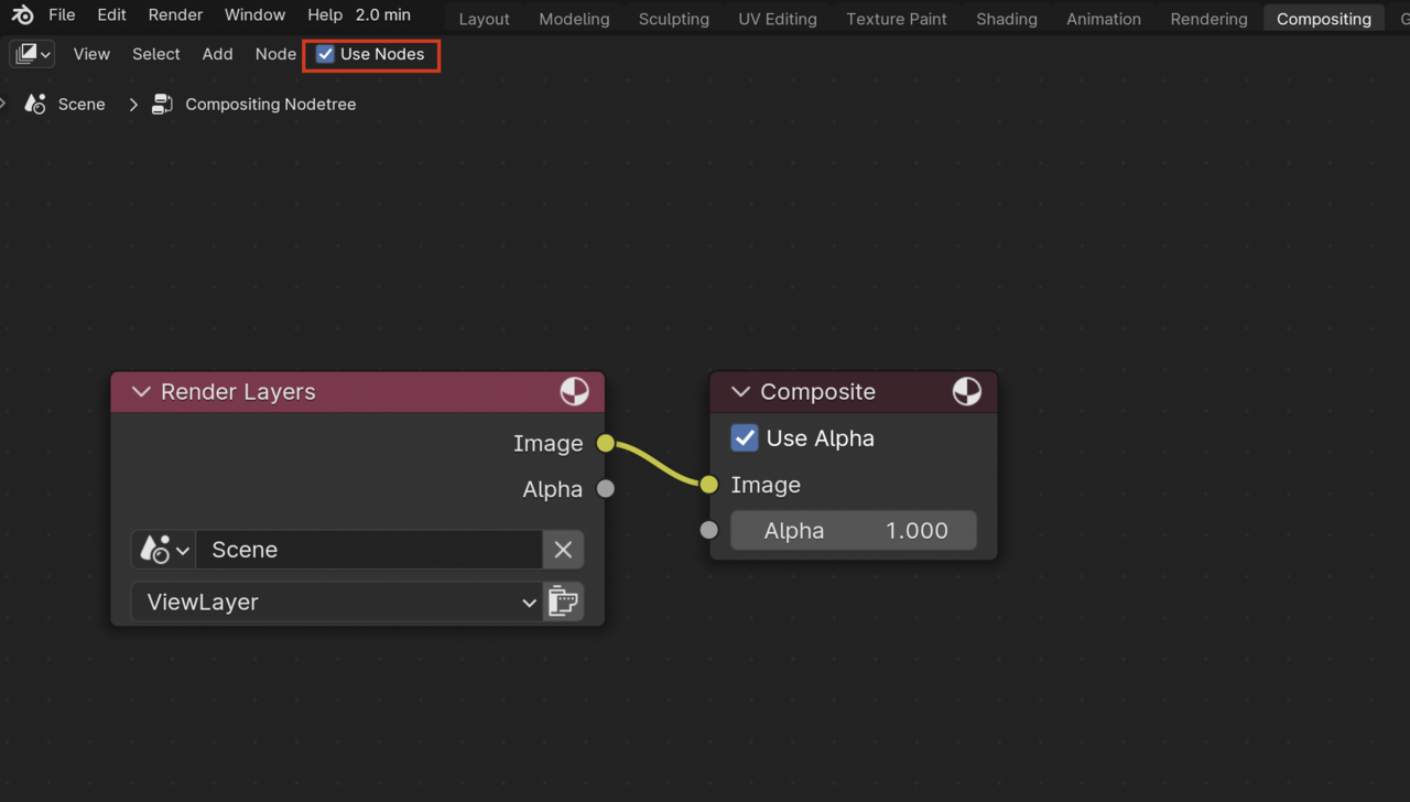

    You can disable “Use Nodes” In the compositing workspace. That way your frames will be rendered without pipping them through the compositing nodes and after they are done rendering you can get them back into compositing and only then pipe them through. This workflow allows you more flexibility in case you change your mind in the post-production effects.
    You can do it either way, there’s nothing wrong with burning in the post production effects of compositing directly to your render.
