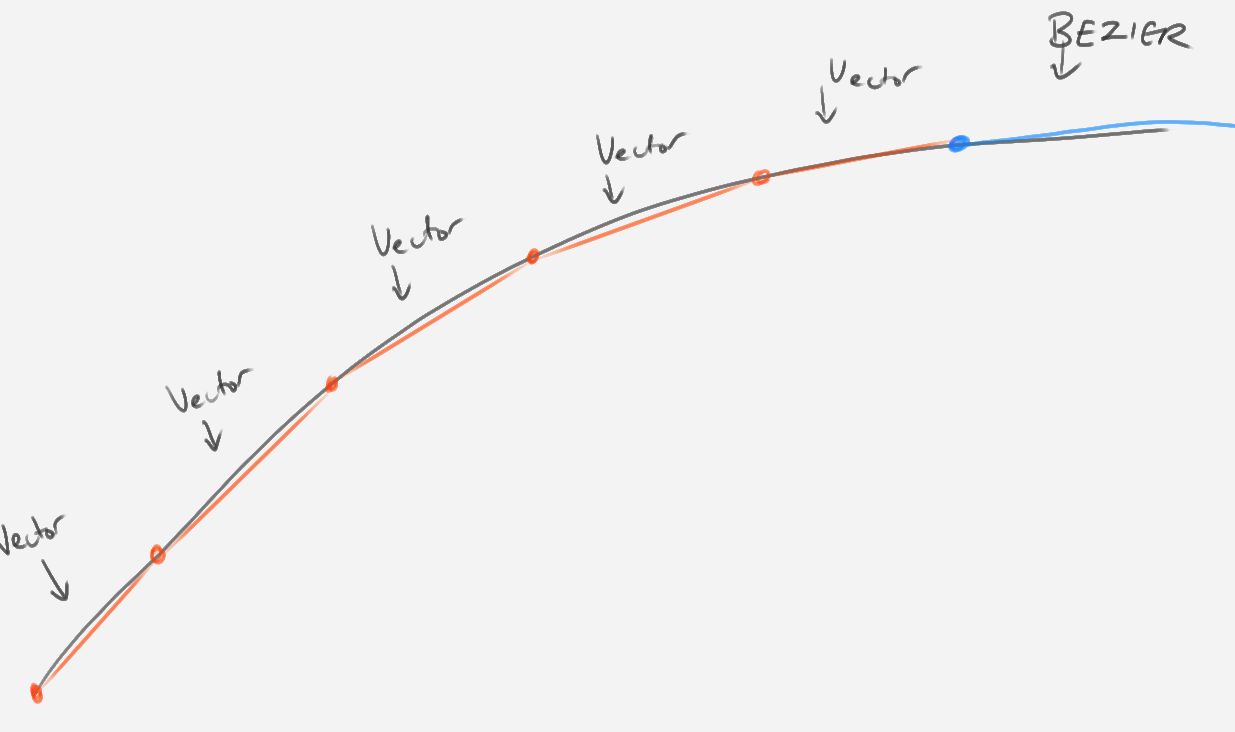

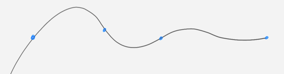

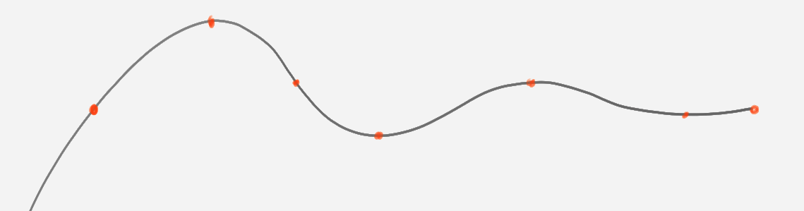

    Imagine this curve below…..(it’s not to scale and I have just quickly sketched this out so it’s not 100% accurate but hopefully it illustrates the point)
    An animator could place keyframes at each one of the blue marks.
    Or at the orange marks
    Or a combination of both.
    The result is the same so which is better?
    The way that got you to the end result the quickest and easiest.
    (This will be different for everybody)

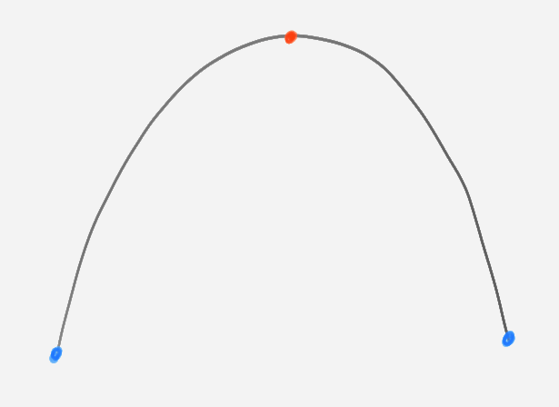

     In your example that doesn’t have the keyframe at the top of the arc.  That is certainly possible.  But that’s only something I do on the really small bounces.
    For me, it’s easier to have that orange keyframe there – and that way if you need to adjust it, that is what you adjust.  The other side handles are easy because I know what shape the curve should be (I’ve seen a lot of animation spaghetti)
