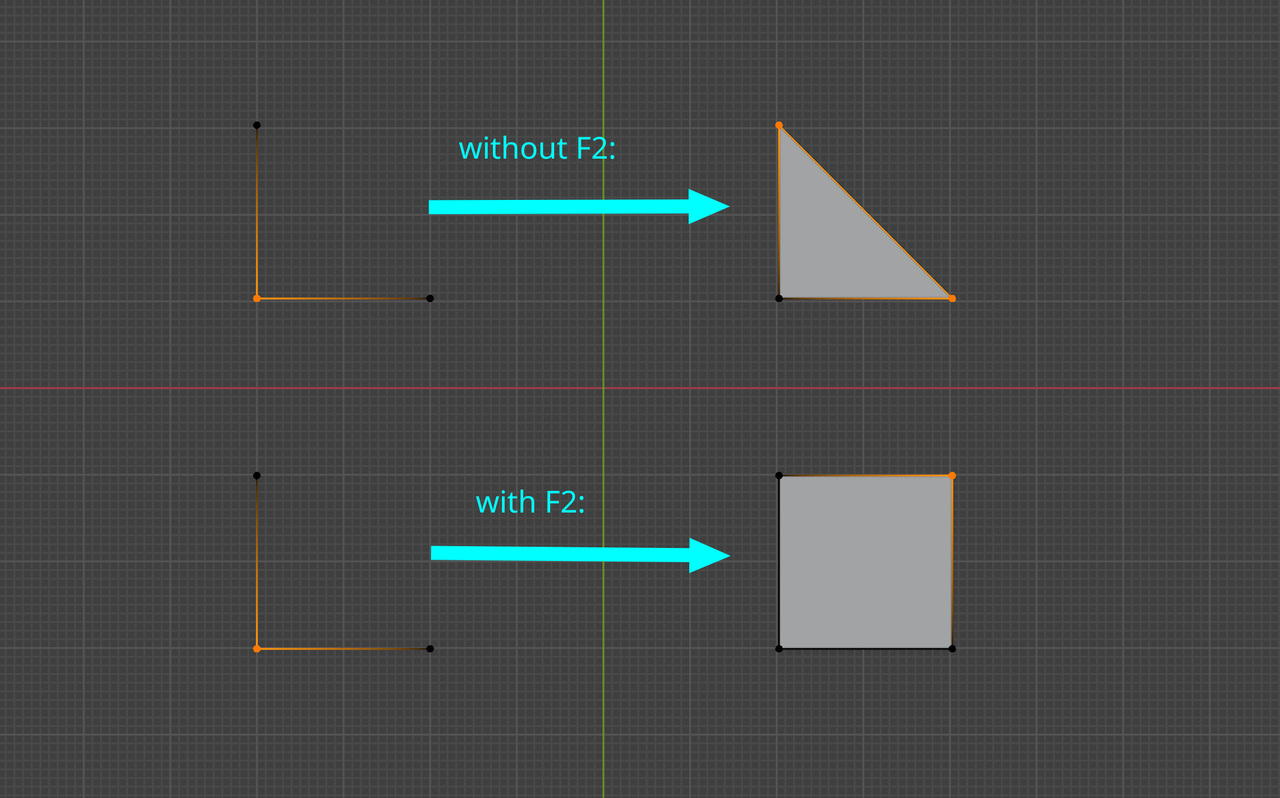

    And to make things a bit more complicated, a lot, if not most modelers have the Addon: Mesh > F2 enabled and that changes (improves) some of the behavior of F.
    For instance:
    Instructors might not always mention that certain behavior is because of F2.
