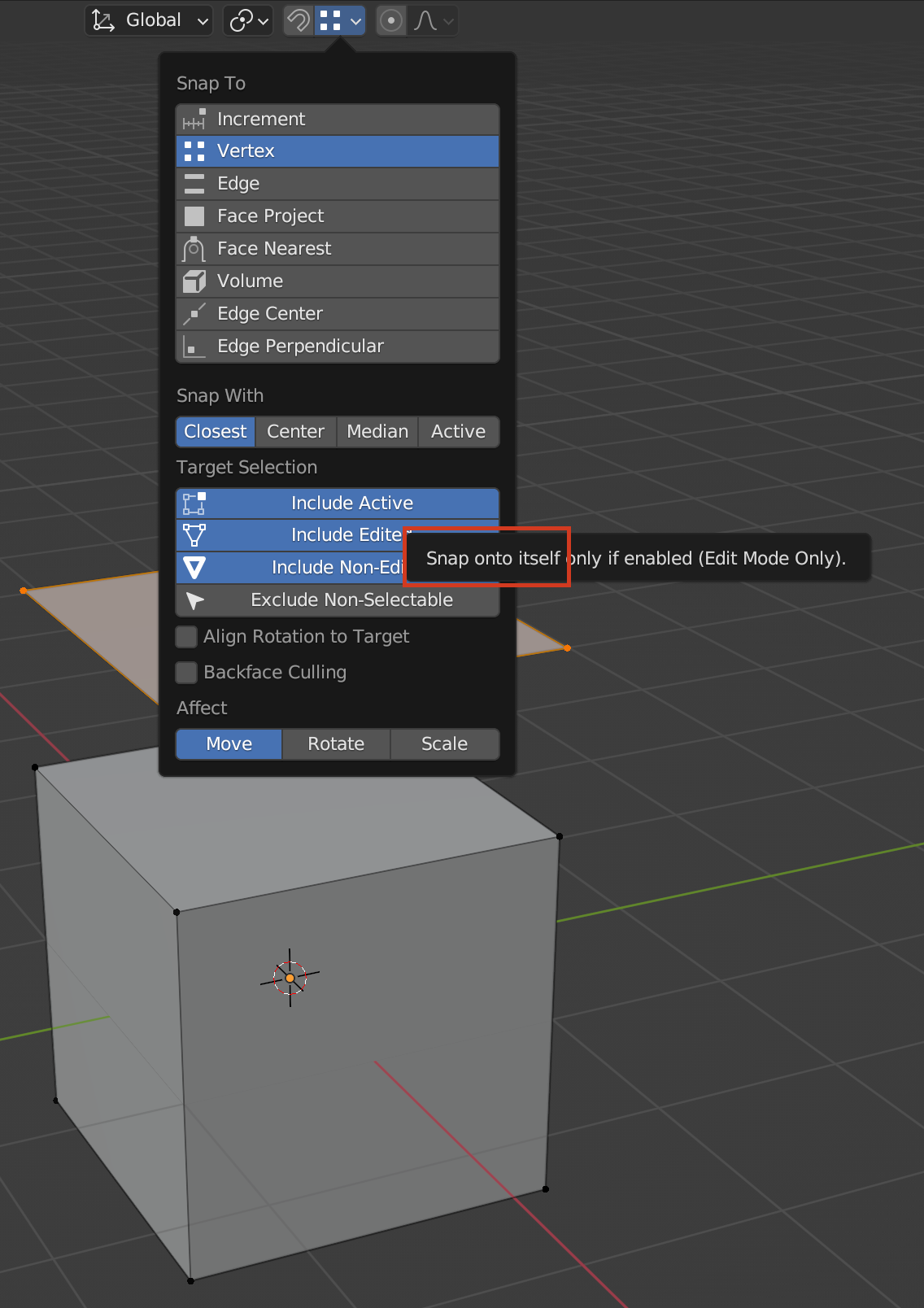

    The minute you said french, I began to read all the text with a french accent. The brain is weird that way. So in Blender names change a lot, in every update they think, hmmm, how can we make all the tutorials irrelevant this time? If you read the tool tip for “Include Active” is that same functionality.
