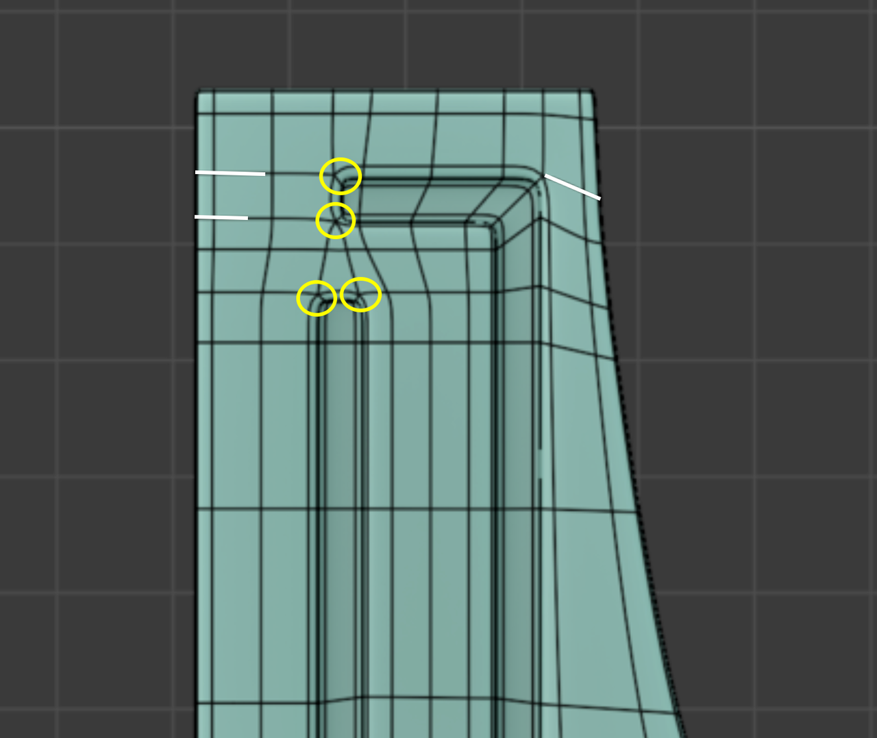

    Hi Deb,
    That looks much better!
    Maybe you can have a look at these 4 (yellow) corners; it would be good to have a holding Edge on each side of those, that will improve the bending. Also, while you’re at it, I don’t particularly like that these 2 white Edges on the left turn into 1 on the right:
    But overall a huge improvement already!
