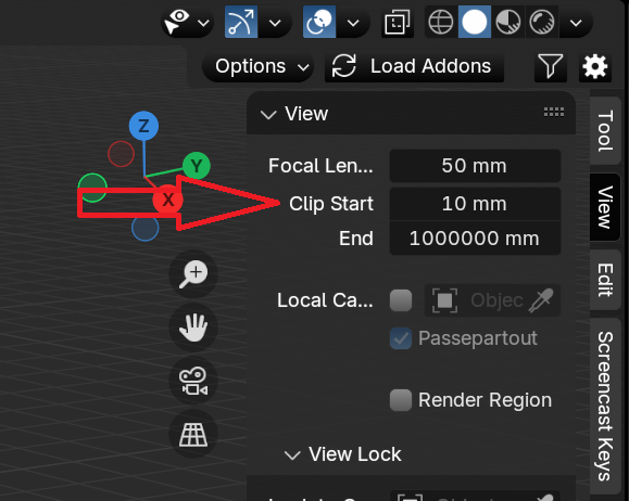

    That’s the view clipping cutting into your mesh. If you open the n-panel and check under “view” you’ll find “clip start”. If you reduce that value you’ll be able to get closer.
    Note for camera views: A camera has it’s own clipping values, so when you set up a camera for a shot and want to get close you might have to adjust its clipping value separately.
