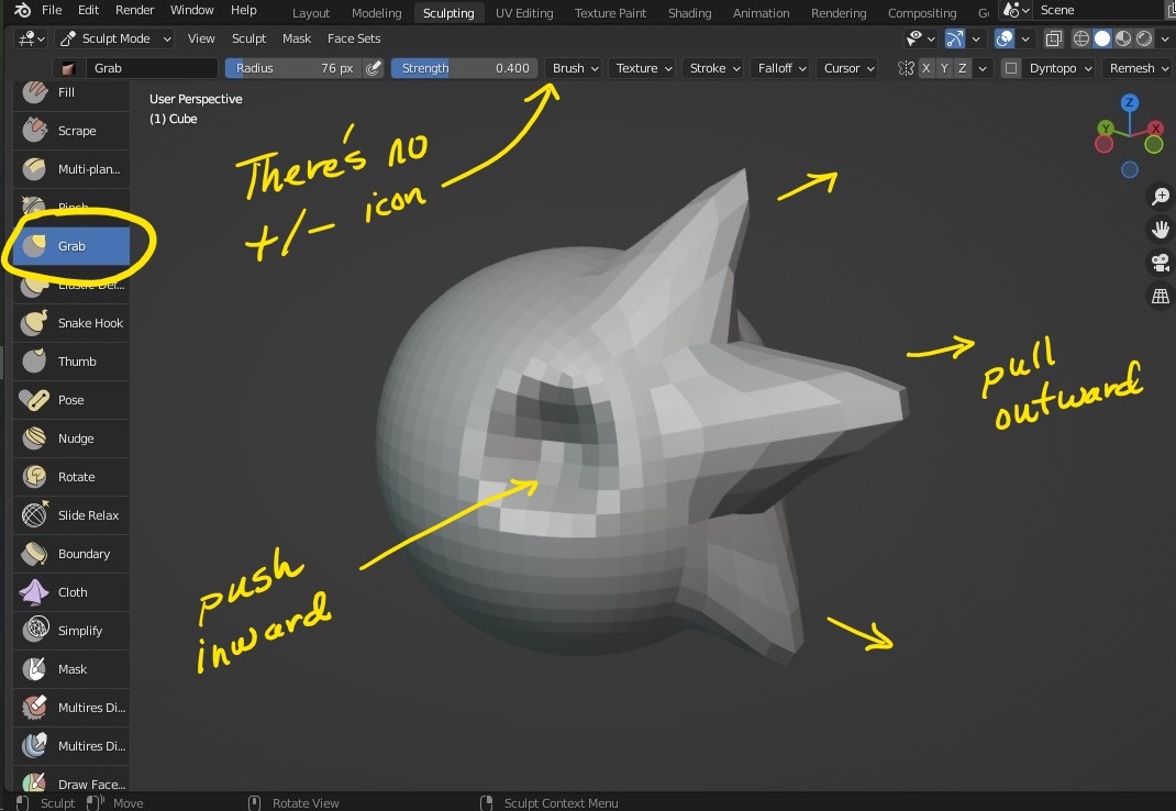

    @naiad I’m just playing with you. 😊

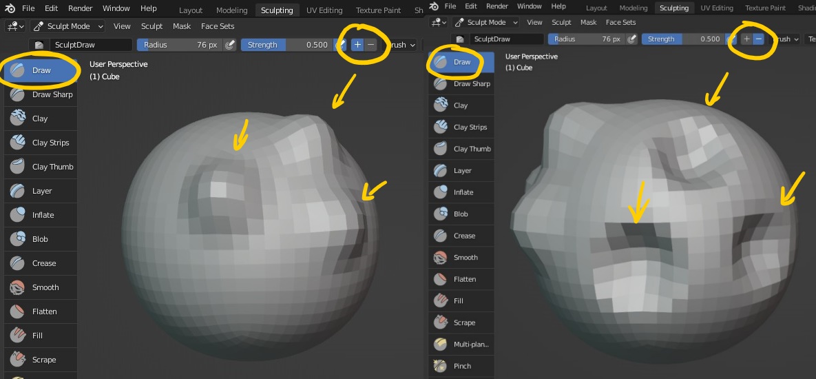

    If you have good eyes you may notice there’s no plus or minus icon at the top. Even you hold CTRL and use the grab tool to make a mark on the mesh, it doesn’t make the difference.
    Other tools may have plus/minus icon. CTRL works on them as well.
