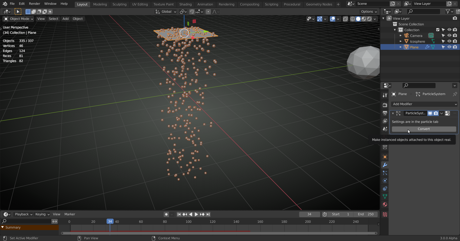

    Sure @cgdummy !
    Go to the Modifiers tab and press the Convert button in the Particle System Modifier:

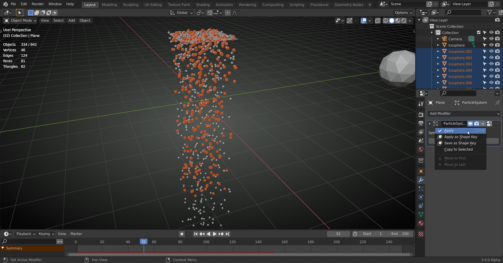

    Note that there also is the Particle system left now! To remove the Particle System you can Apply the Modifer (dropdown arrow or CTRL+A while hovering over the Modifer):
