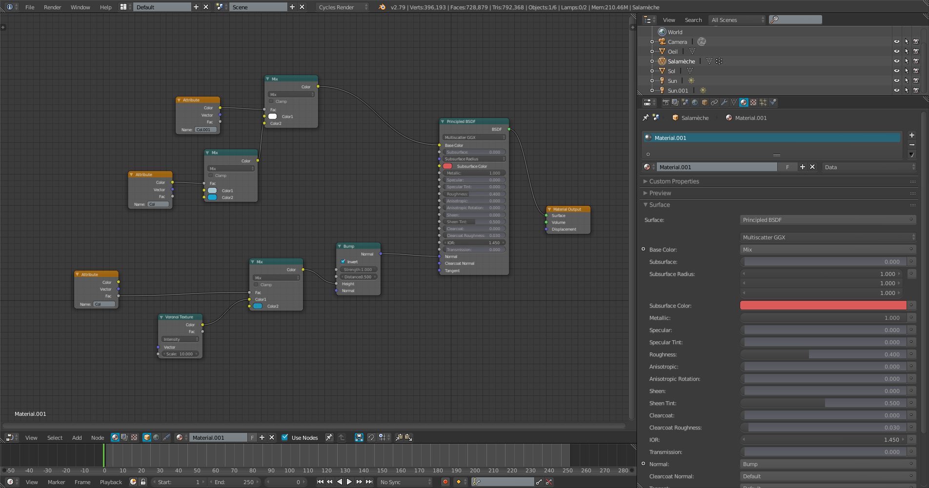

    @tbrbn It woooooorks !
    Thanks it seems i need to work a bit more on shaders ! ^^
    Here is the material to get this render: So… if i’m right:
    -The “Fac” output of the attribute node (at the bottom) says “this is the belly of charmander”
    -To put it into the fac input of the mix shader says “The belly and the rest of the body of charmander are two different parameters:
    Color 1 is the belly
    Color 2 is the rest of the body
    -Plug the varonoi texture into color 1 says “The belly is colored by the varonoi”
    -Let the color 2 without a texture says “no bumps here”, just the default parameter.
    Weew !
