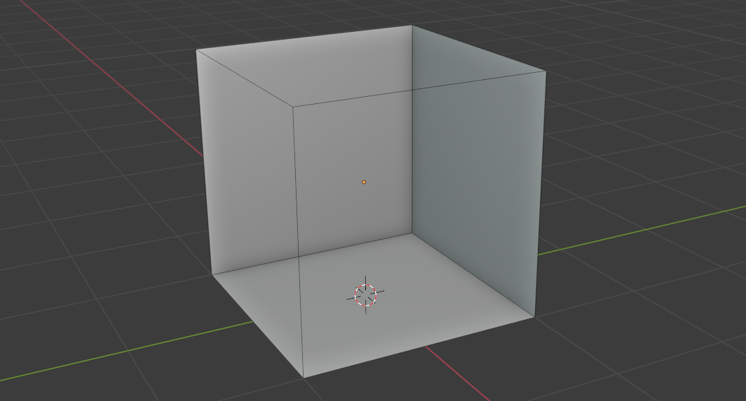

    Here’s a default cube with the faces flipped and backface culling turned on in solid view:

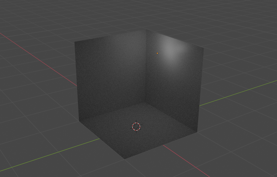

    Then to get the effect in rendered view, the faces near the camera are separated and camera ray visibility is disabled. I added a light so you can see inside, but cutting a window or something would work equally well:
    I’m not sure what you mean by the cubical room not rendering. Perhaps camera ray visibility got unchecked on both parts instead of just the front part?
