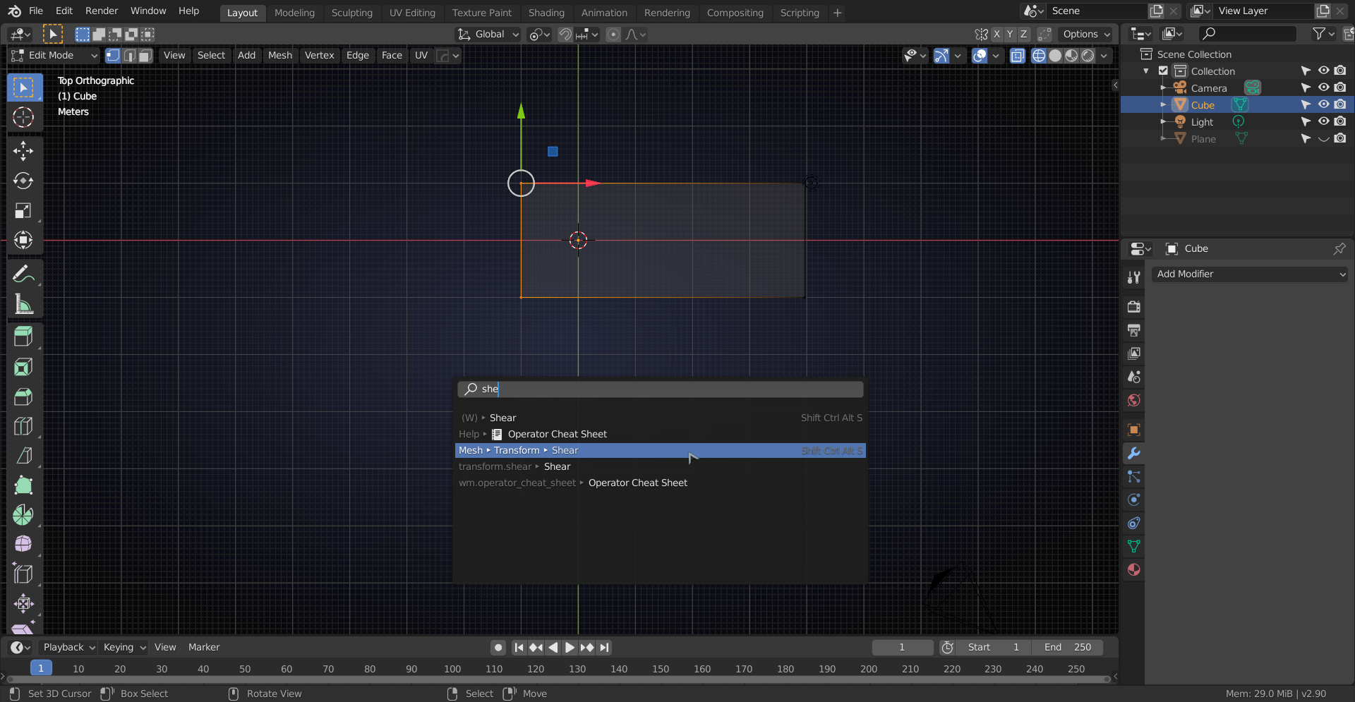

    In this specific case you can use my all-time favorite Blender shortcut SHIFT+CTRL+ALT+S to Shear with a value of -1:

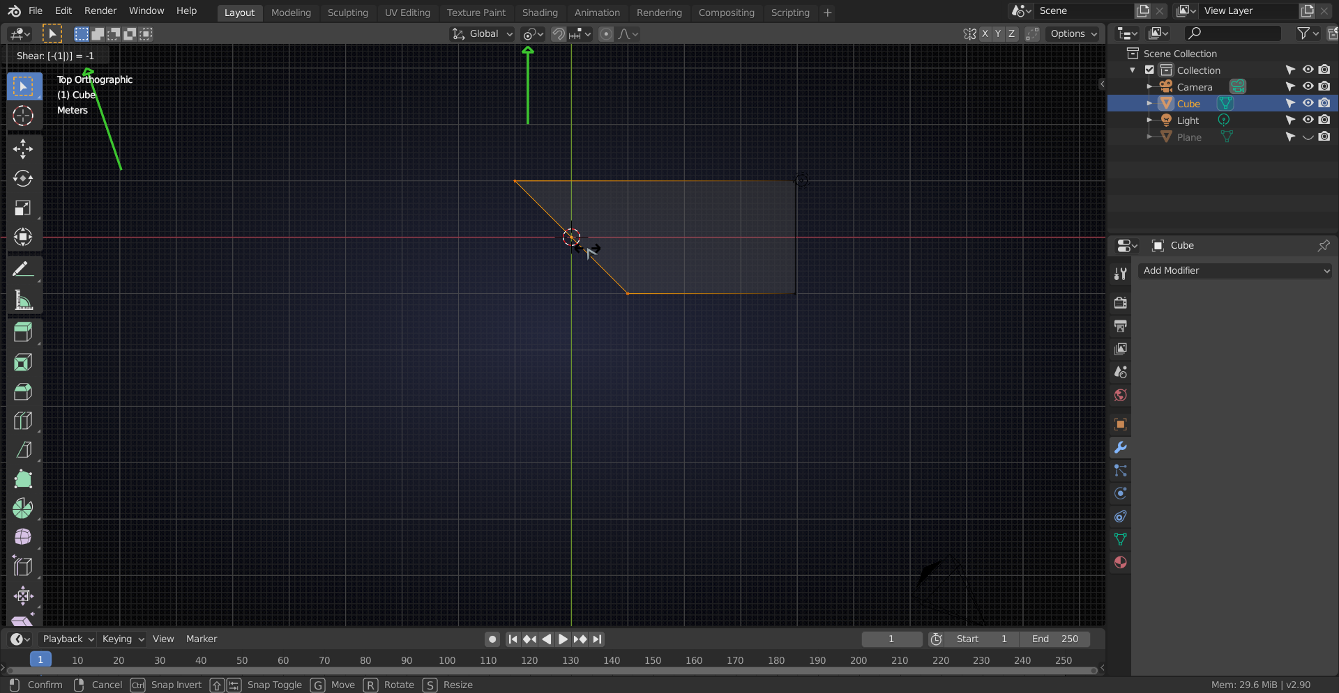

    which results in this:

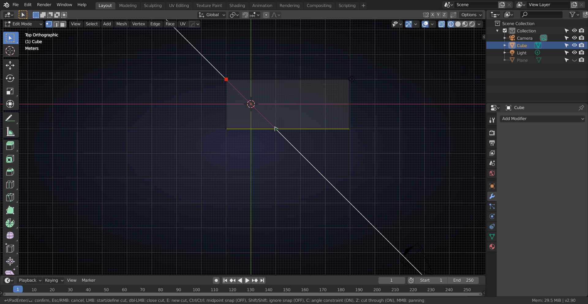

    or, use the knife: K (to cut), C (to constrain the cut to an angle), Z (to cut through the mesh):
