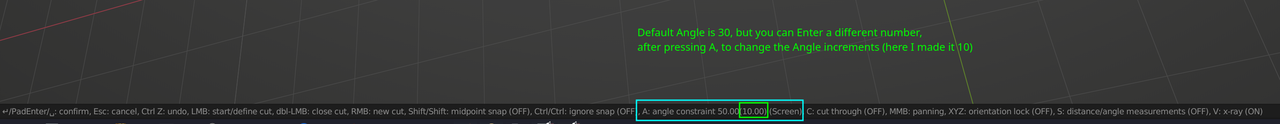

Press K, then Enter and then you can press A to constrain to an Angle (increments of 30° by default). Pressing A more than once cycles through different options (Screen/Relative/Off/Screen…)Screen is the one you probably want here.
Watch the options at the bottom of the 3D Viewport:
