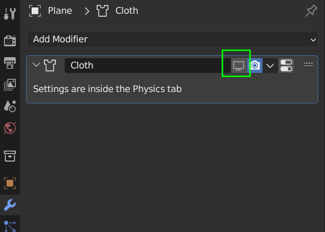

    Hi Leonardo @garabatonegro ,
    First idea, take your first approach and Animated the Camera and Background…
    Second idea, temporarily disable the Cloth Modifier in the Viewport:
    Then set your Keyframes for the Kite and then re-enable the Modifier and ‘press Play”…
