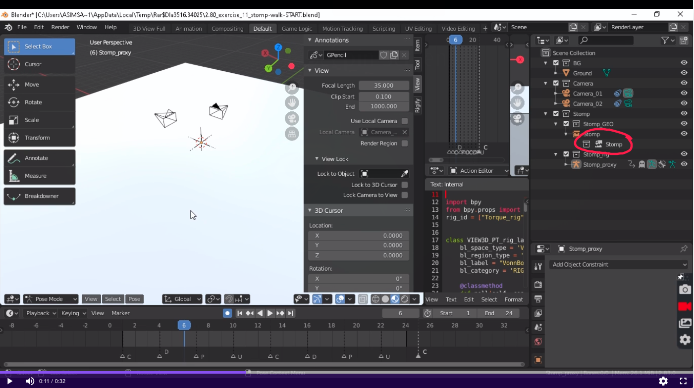

Reply To: i have downloaded 2.80 _exercise_ 11 but cant see stomp in the view port .PFA link for reference

    Hi Subha,
    It looks like the link to the rig is broken.
    This might be because you are launching everything from a TEMP location on your hard drive.
    The linking is relative so it can’t find the location of the rig files.
    Try saving the file and linking in the character like I do in the videos.
    But I’m not sure if I included any starting exercise files for that one. I think the idea was to force you to do it yourself to learn the process.  But maybe I did.
