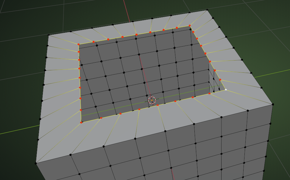

    If you hide the top cubes, you can see better what is happening:
    This is the normal behavior; each Vertex on those Edges are scaled towards the center.

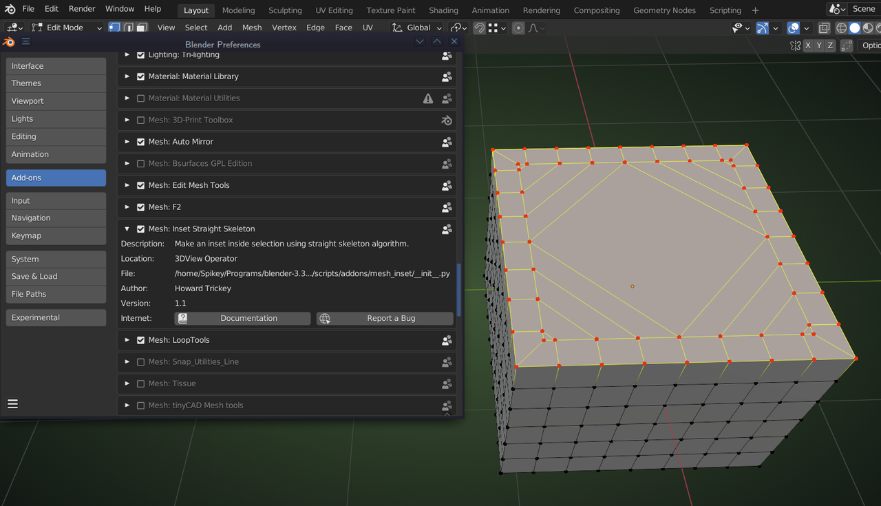

    There is an Addon, ‘Inset Straight Skeleton’ that, when you fill in a Face and then Search for Inset Straight…., or goto Face > Inset Straight… would give you:
    Which might be more what you are looking for…you’d have to Delete some unwanted Geometry and maybe Merge those three Verts on each of the corners, but it’s a possibillity.
