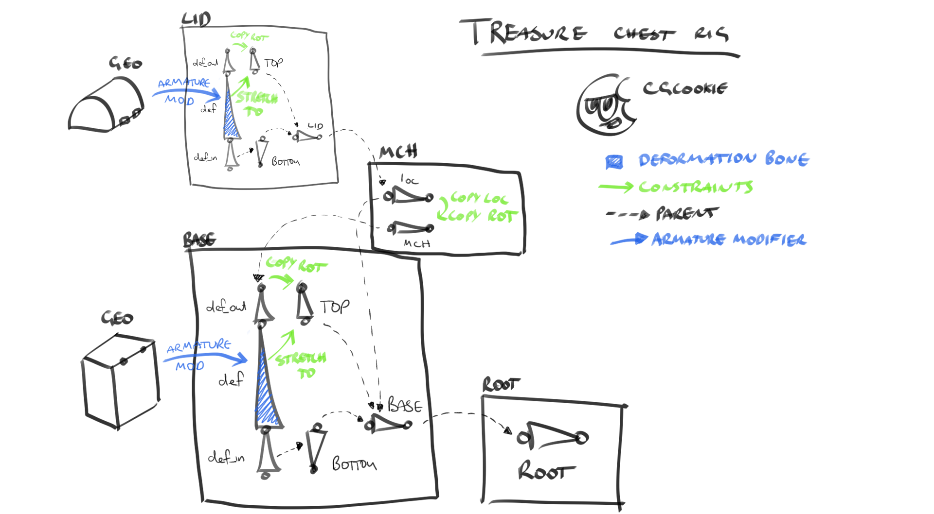

    Hi Kyle
    Check out this handy schematic.
    You missed 1 small thing.  The base_def_out parenting is backwards.
    How do you fix it?
    The Lid_MCH should be parented to the base_def_out (not the other way around)
    Then make sure the base_def_out is parented to the base_def (connected parenting so it gets the bending to work)
    Hope that helps.
    The fix shouldn’t break any of the animation you have done either 😉
