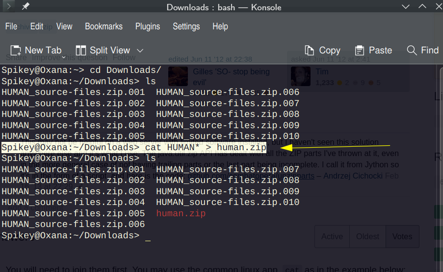

    @theluthier on Linux, I found the easiest way is to combine them into 1 .zip file (with the (con)cat(enate) command):
    Then you can unzip that single .zip file with your standard tool.
    This principle/trick should also work on other OSs, I think. Windows Powershell even supports ‘cat’ if I’m not mistaken.
