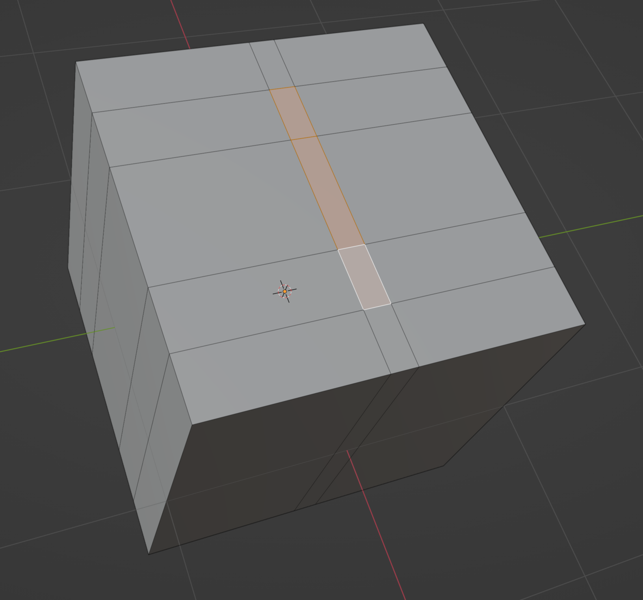

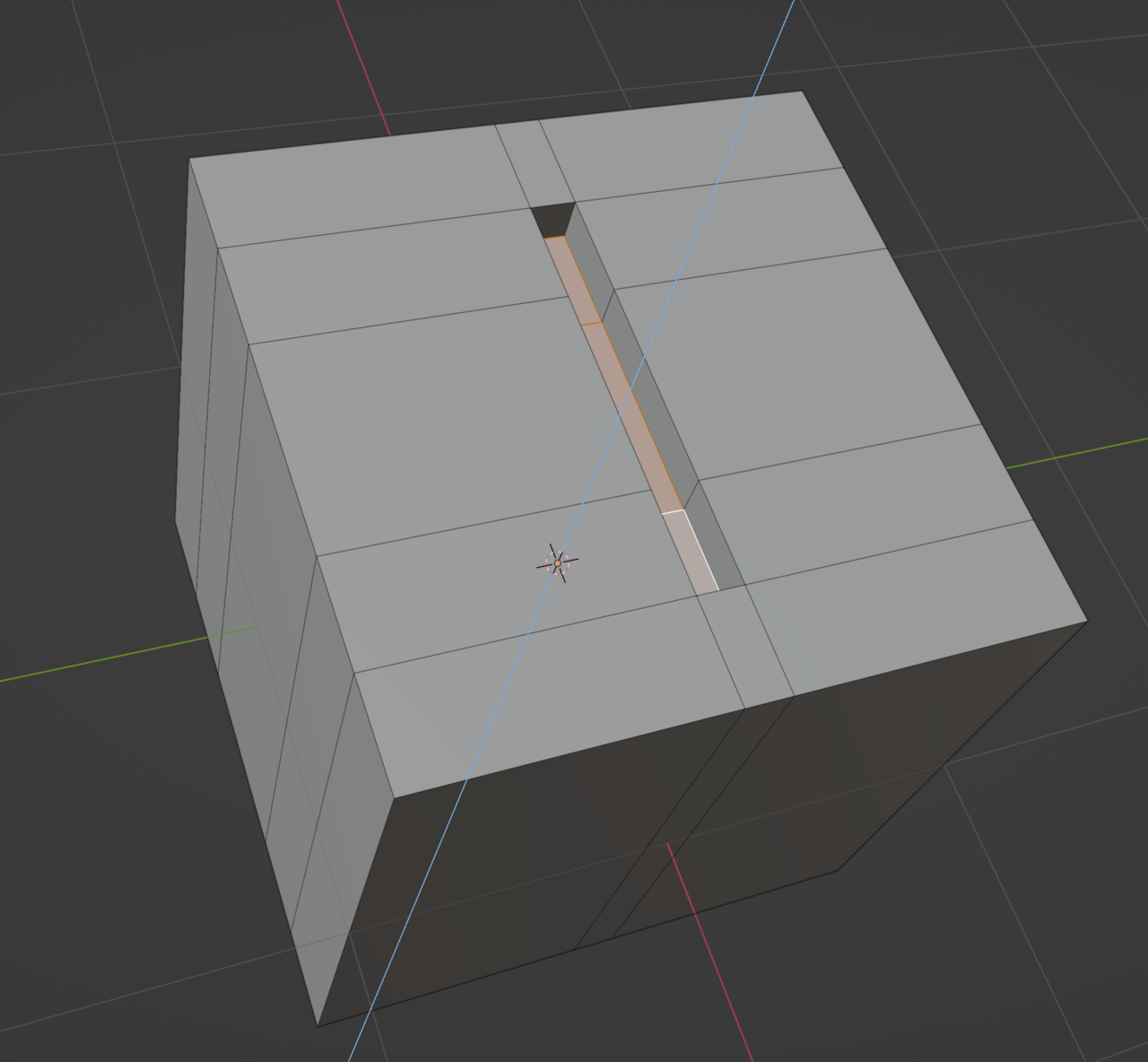

You can also make the gap afterwards. Just make two loops as close together as you want the gap to be wide, then just extrude it in and you’ll have the gap.
