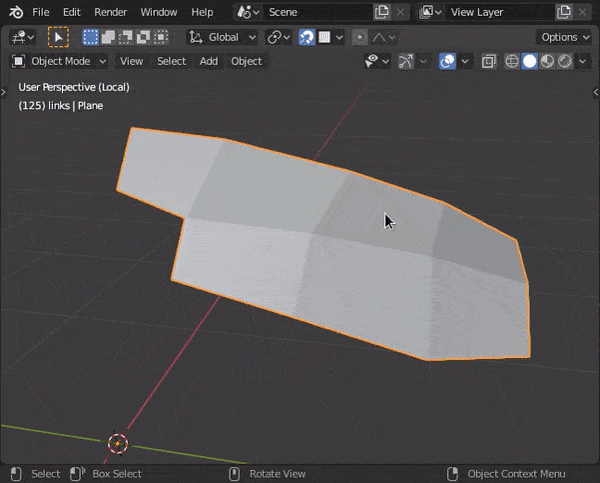

tried to shade smooth my retopologized model but it showed some weird cracks after smoothing the model. What is wrong?
This happens a lot with retopology and it has to do with inconsistent face normals. As we extrude edges and fill faces randomly through the process, Blender doesn’t automatically know which way is inside or outside of the mesh. You can confirm this is the issue by enabling the “Face Orientation” overlay where blue faces are pointing outward and red faces are pointing inward. In edit mode simply select all faces and use the Mesh > Normals > Recalculate Outside option (or SHIFT + N is the hotkey).
