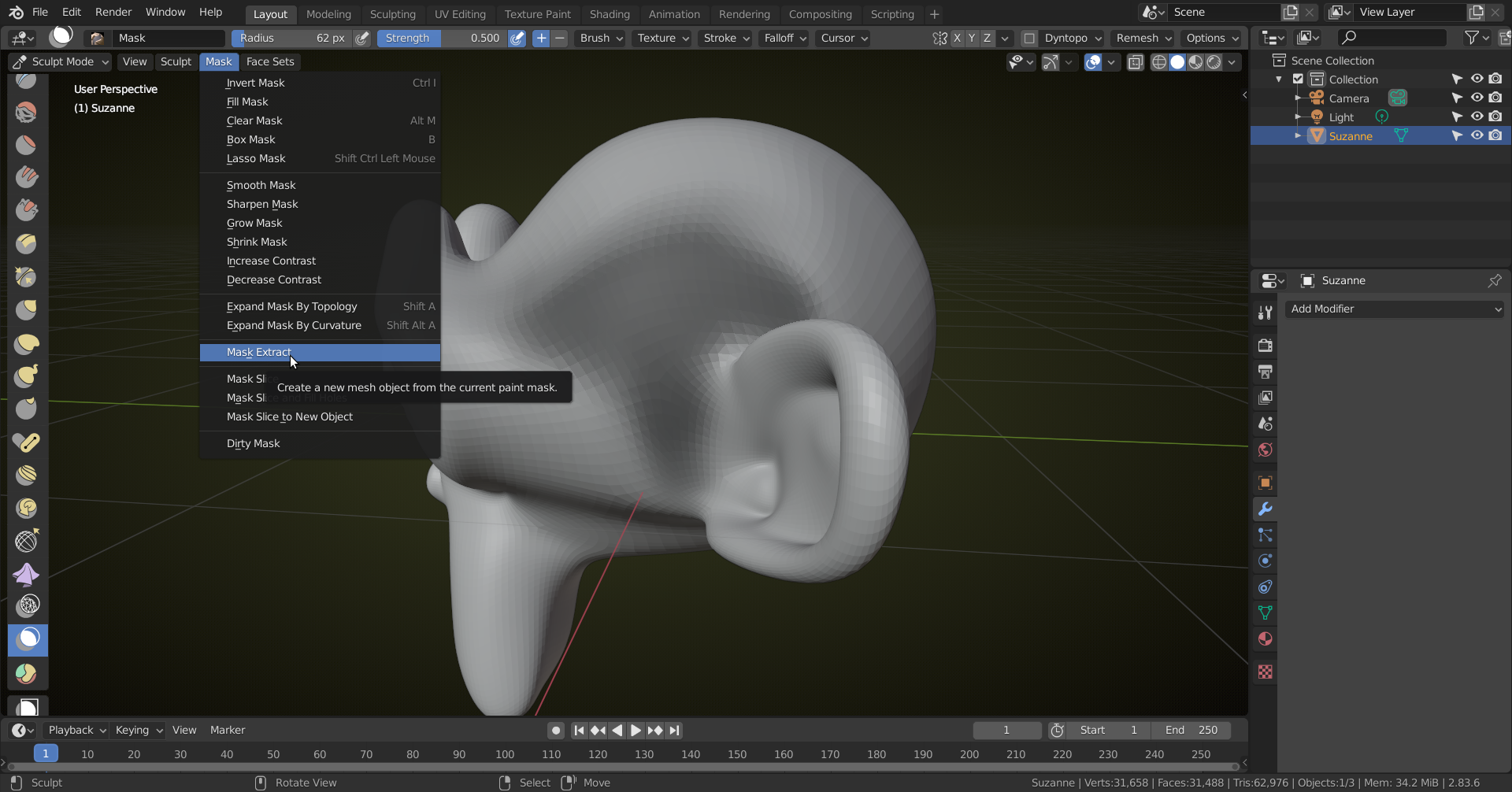

    That was in version 2.75 part of an Addon: ‘Sculpt Tools UI’, I think. This Addon is no longer maintained and won’t work with modern versions (2.8+) of Blender.
    When using for instance Blender 2.83 LTS, you have that functionality built in in Blender.
    Go to Mask > Mask Extract:

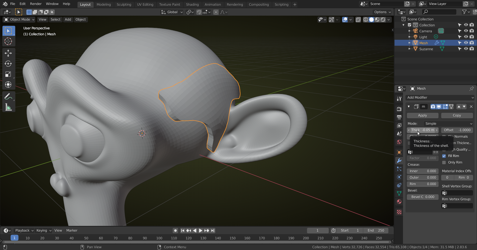

    After pressing OK, you get a new Mesh from that Mask:
    Pay attention to the fact that you are now in Object Mode with the new geometry selected and there is a SolidifyModifier where you can adjust the thickness, add a Bevel and some more…
    You’ll have to apply the Modifier before you go into Sculpt Mode for that Object.
