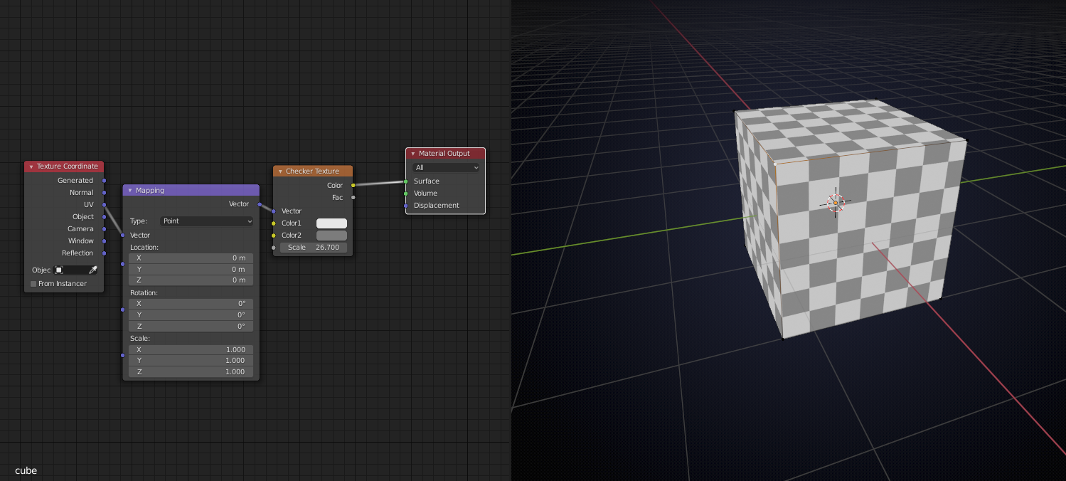

    Suppose you have carefully unwrapped and textured your model, like this:

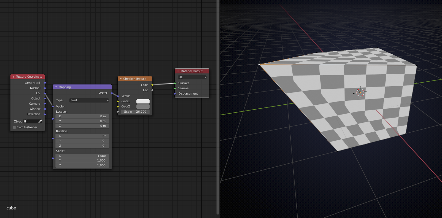

    But the you decide to change the shape a bit, by moving vertices (or using a Lattice). This will happen to your texture:
    It depends on your texture if that is a problem or not and how much deformation is acceptable.
