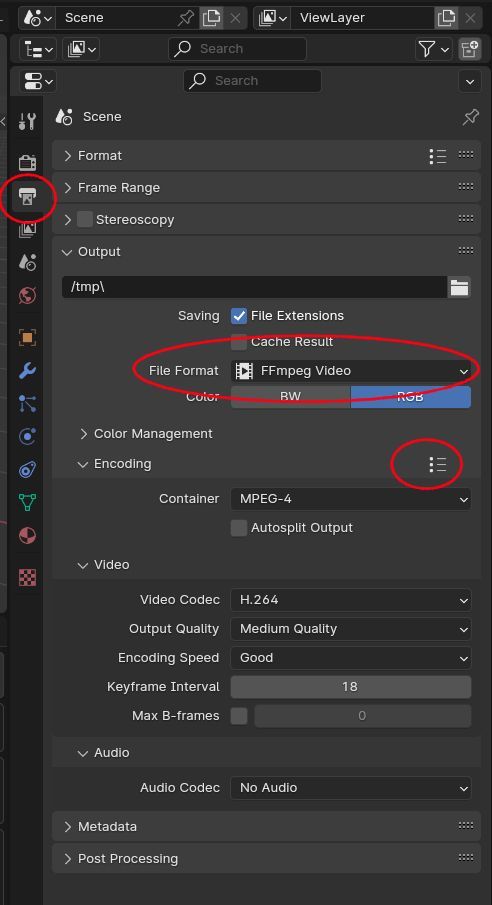

You need to change the output settings from an image to a video format, then specify the container and codec, click on the 3 dots and dashes for presets.Those shown below are a standard mp4, then you will need to render animation (CTRL+F12)
