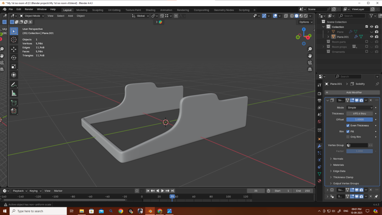

    So basically, we’re mirroring the part, then adding thickness with Solidify (which creates another edge), and after adding Subdivision we’re just smoothing between those edges — kind of like a bevel, but without creating unnecessary polygons.

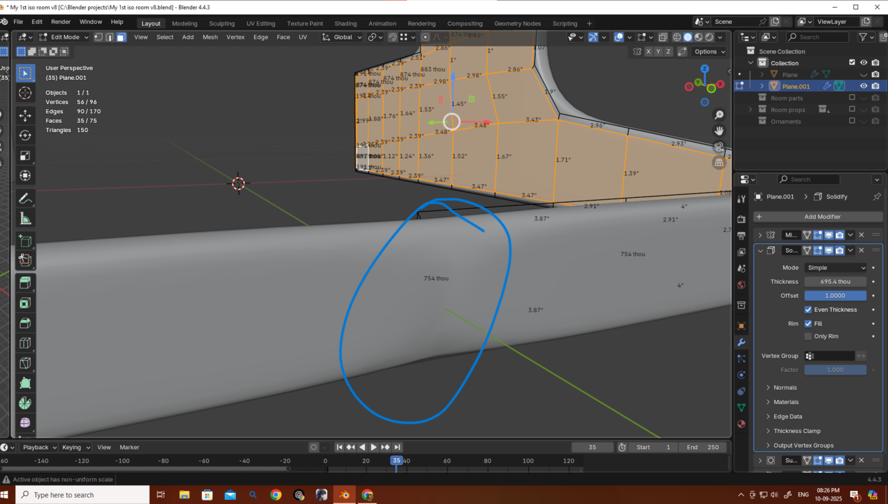

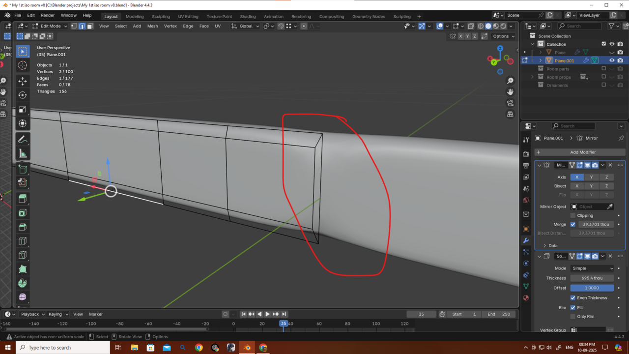

    But I’m running into this issue.

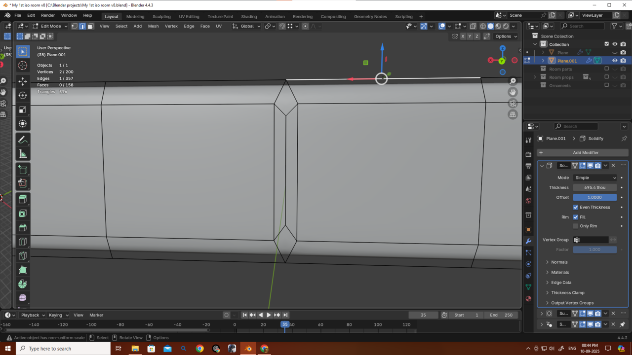

    I tried fixing it this way: after applying the Mirror modifier, I added two vertices, connected them, and created a diamond-shaped quad as u yesterday told me — which fixed the issue.
