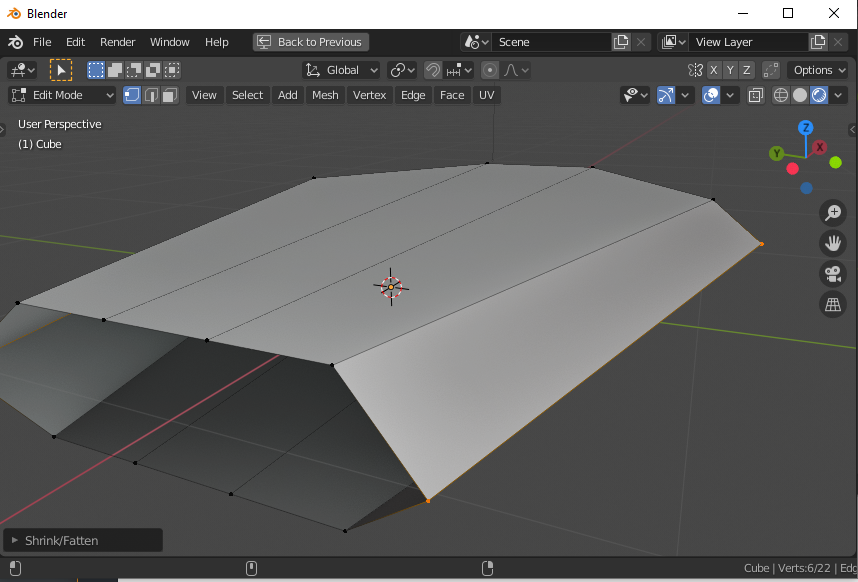

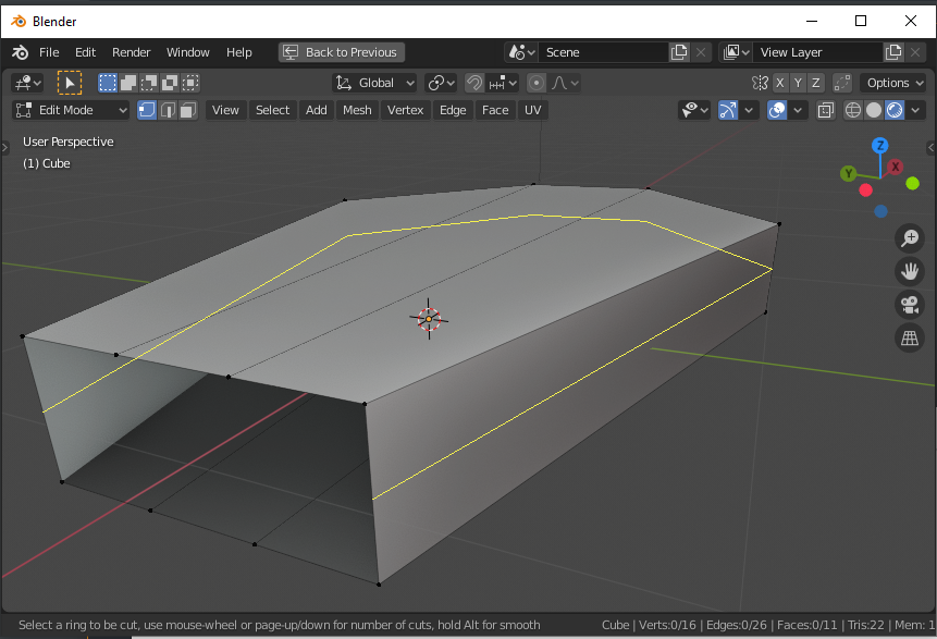

    @shanr Another method similar to @spikeyxxx could be to make an edge loop using Ctrl+R
    Scale the new edge loop along the normal using Alt+S

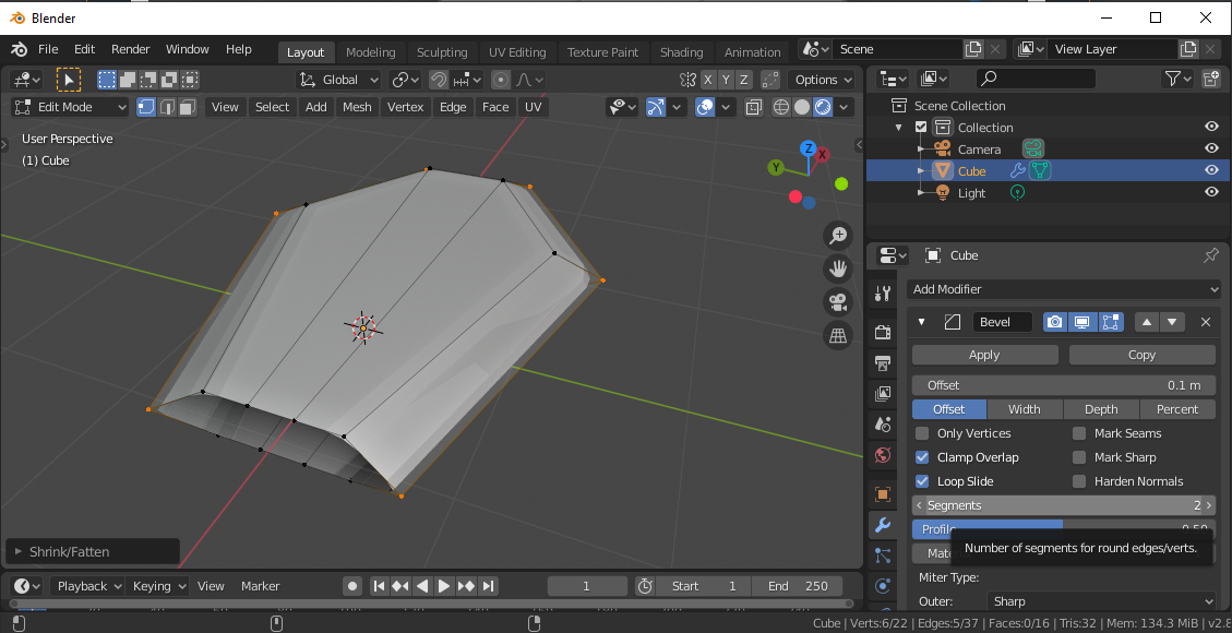

    And to finish things off you could add a Bevel or Bevel Modifier and play with that Scaling along normal for that new edge loop to get a sharper looking geometry. Play with the number of bevel segments for the shape. Also Blender 2.82 has some extra bevel tools that are pretty slick. I’m not going to explain them but you can look them up.
