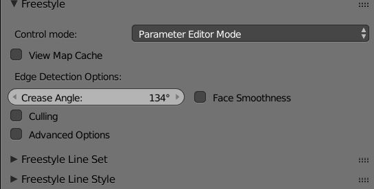

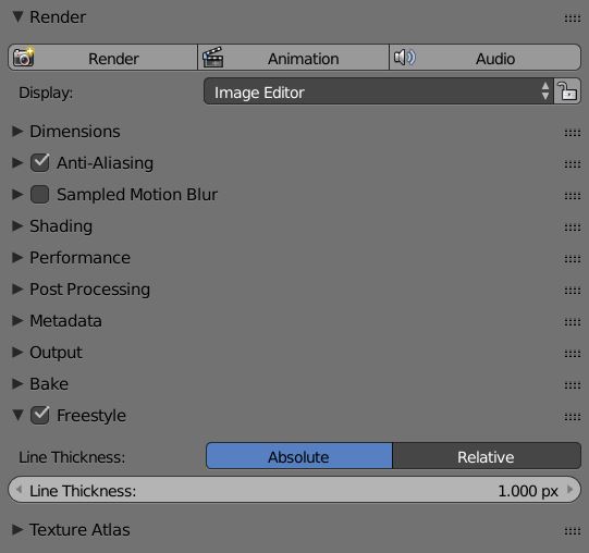

    Hey Jason, there sure is! It’s called Freestyle, and it draws lines over top of a Cycles or Blender Internal render. Here’s it in action over a BI material set to shadeless:
    You can turn it on in the render properties, and tweak it in the render layer properties:
