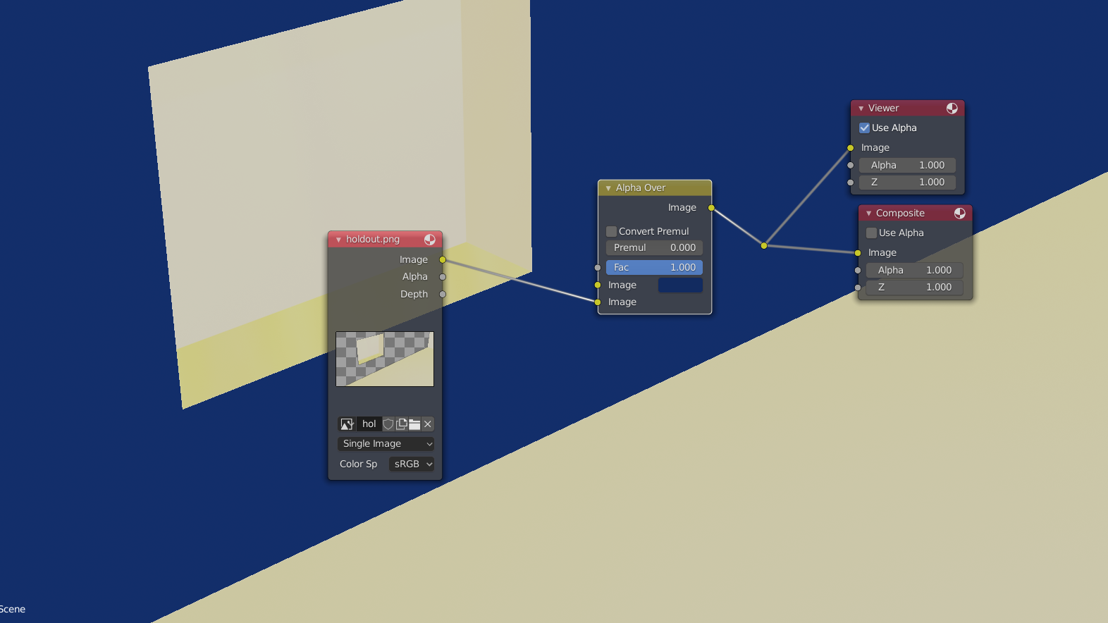

    There are several ways of getting the result you want, but if the wall is visible, it reflects light (otherwise it wouldn’t be visible!).
    But if you for instance give the wall a Holdout Shader, the you can overlay the image over a wall that you like and the light reflected from that wall will not be reflected into the bedroom…
