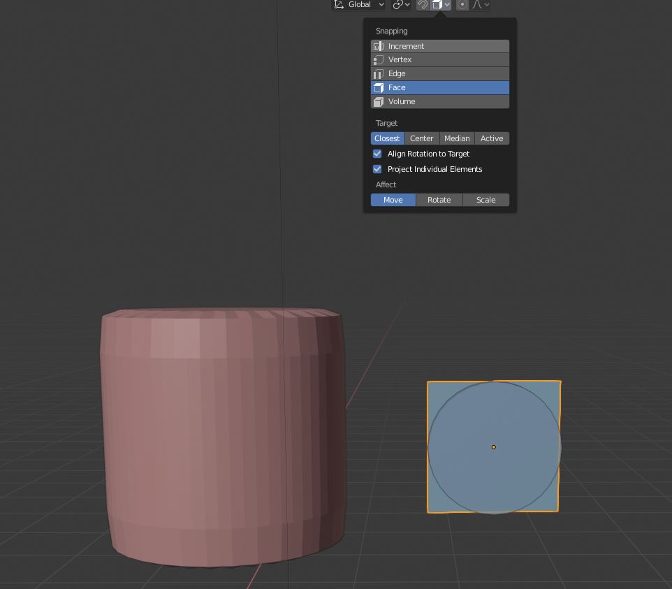

    First, I created a cylinder and a scale (in this example just a circle). Behind the circle, I created a grid plate (picture 1).
    Also, make sure you use face snapping with align rotation to target and project individual elements.

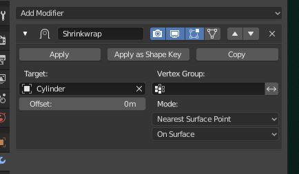

    then i put a shrinkwrap modifier to the grid and use the cylinder

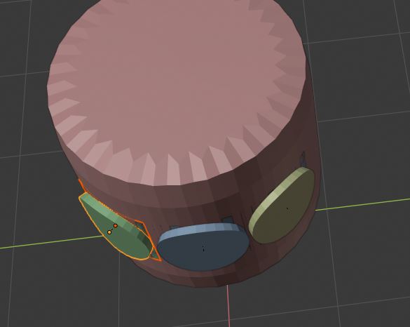

    i parent the circle to the grid. Now i can hover over the cylinder, press ctrl and the circle fits perfect to the cylinder.
    That’s how I solved the problem with the scales on the cylinder. I can recommend, that you but the scales to the cylinder at very least because the performance is getting worse and worse especially if you use subsurf too.
