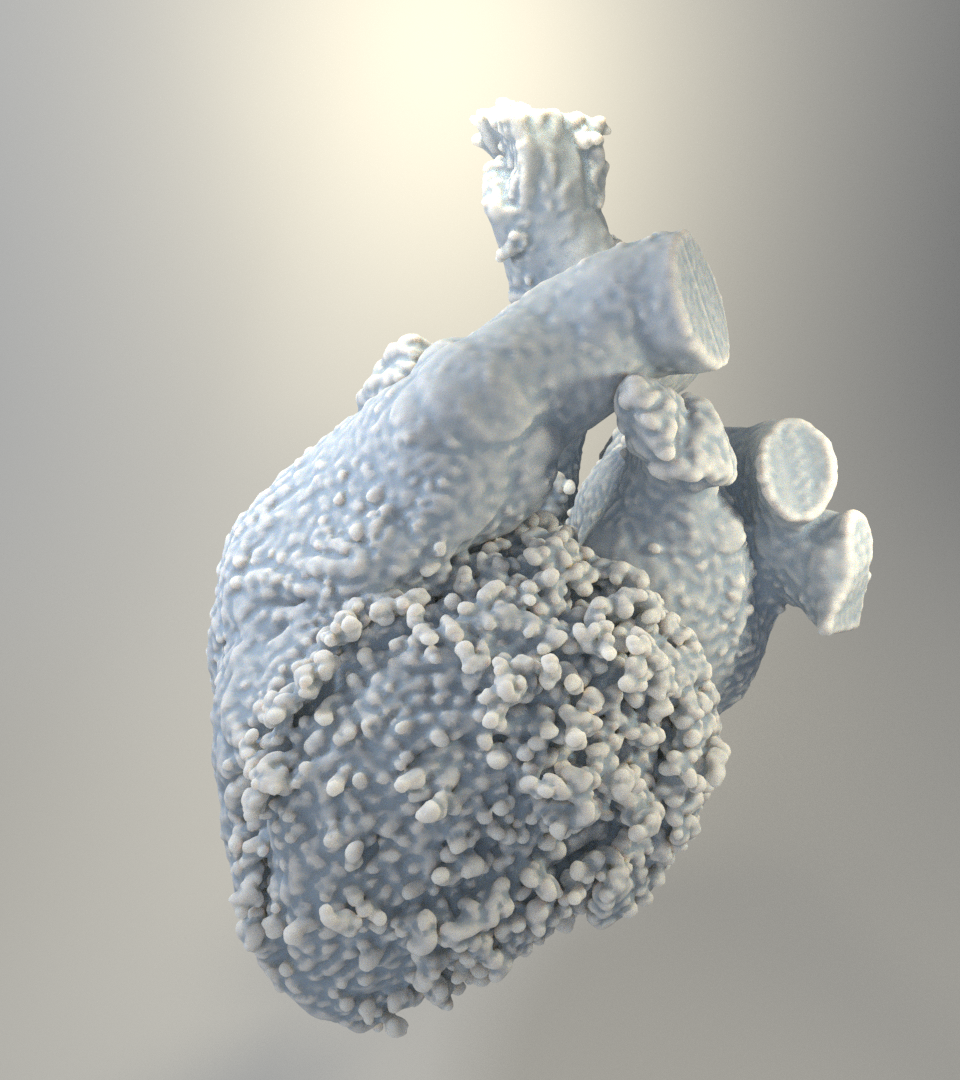

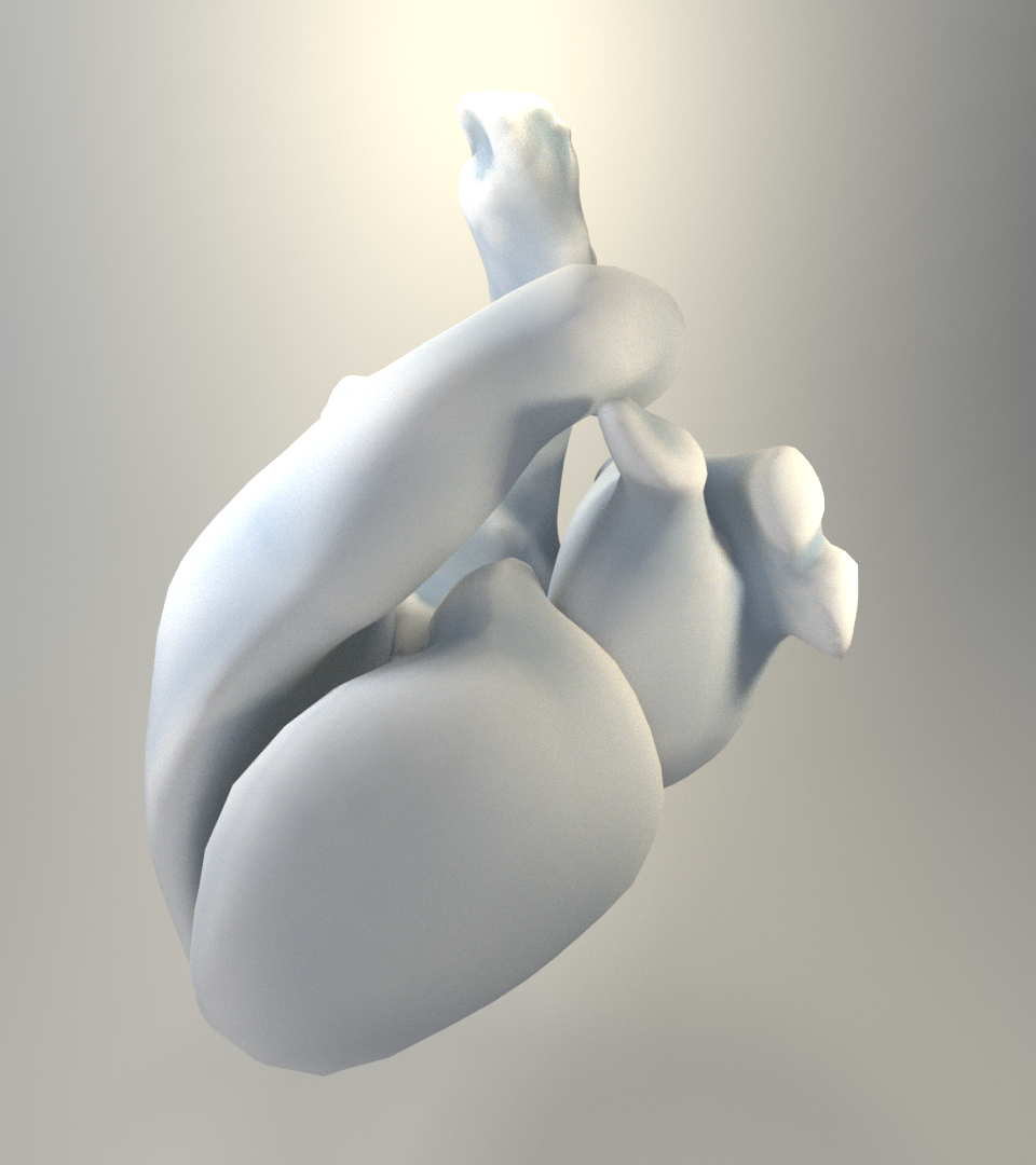

    Our company uses anatomical models to simulate conditions of the human body and test our products. As a quick lesson in CAD and Solidworks; it HATES high triangle counts! Anything over 15k and it bogs down and quits. These CT scans easily pass the 2million tri count. Problem is we didn’t have any software that could reduce the triangle count and still keep the detail required to run the tests. The answer? Blender! With knowledge of retopology from CG cookie and a bit of trial and error I was able to provide a low poly version that preserved the detail we needed and was able to import into Solidworks.
    Raw CT scan >2million tris
    Retopo ready for export <15k tris
