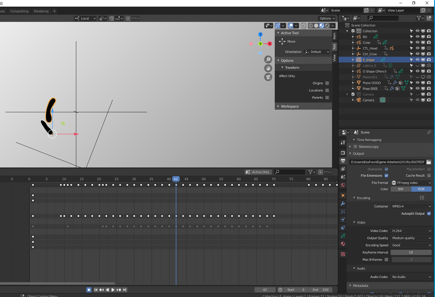

the screenshot is different because for the file I dropped here I left out some things that would come in later in the aniamtion and only put in the version I have problems with.

and this came out ;/ crow is gone again.
the render icons seems to be enabeled for all greasepencil objects too.
