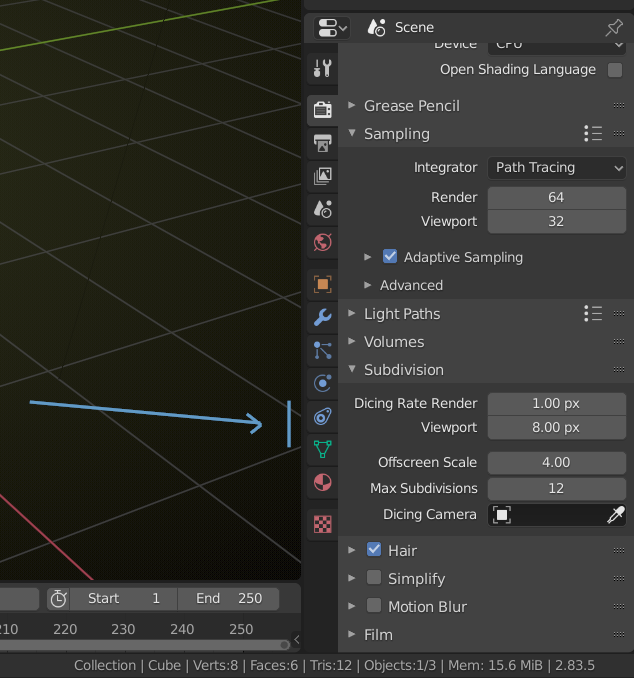

    That is probably because you are using adaptive subdivision and your viewport is set to a different ‘dicing rate’ than the render:
