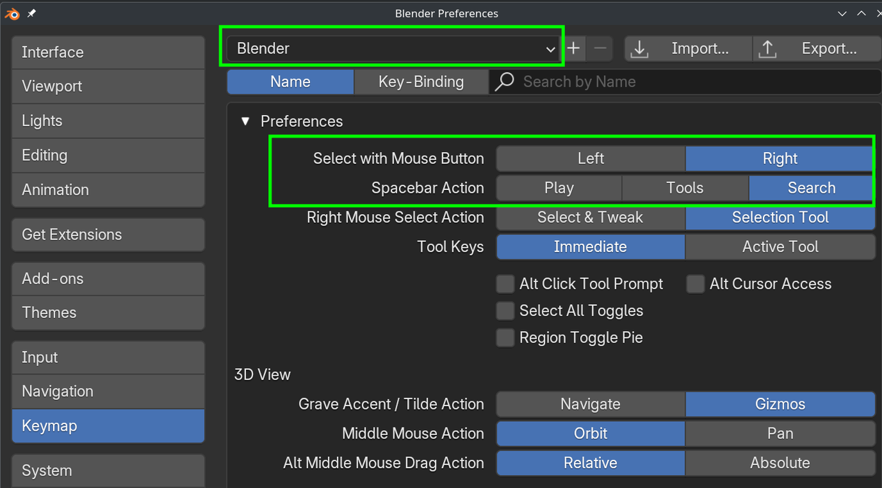

Those 5 Settings for the quick initial setup (and many more) can be found in your Preferences:
Edit > Preferences > Keymap:

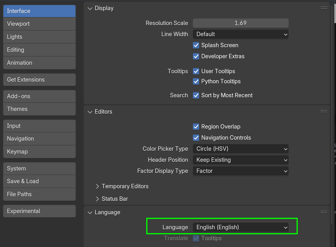

Interface:

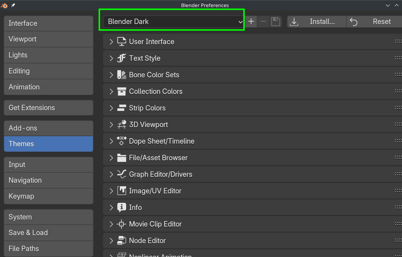

and Themes:
