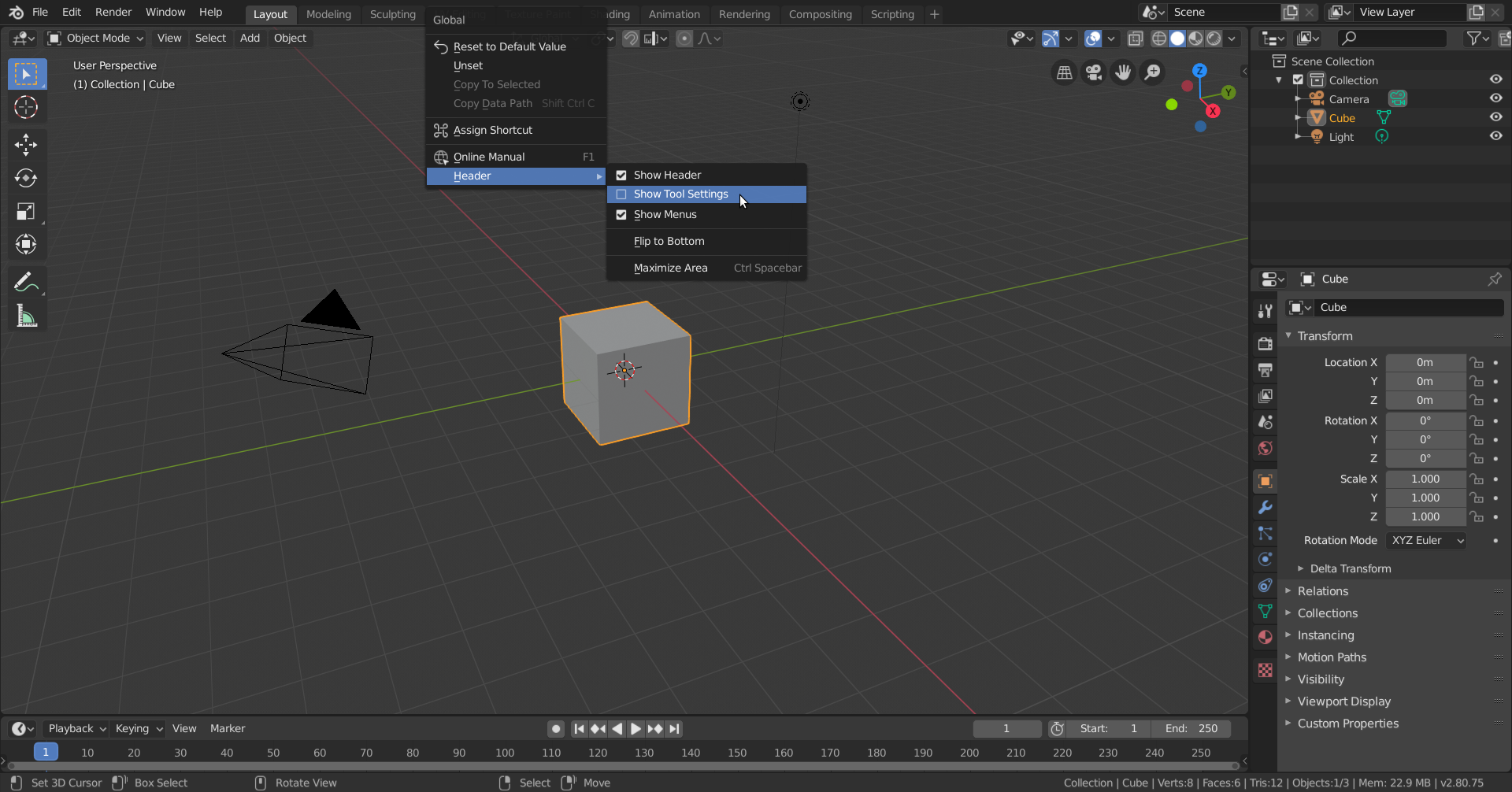

    Right-click anywhere on the Header (where it says Editor Type, Object Mode,…Pivot Point,…etc) and then go to Header > Show Tool Settings:
    Enable it there.
