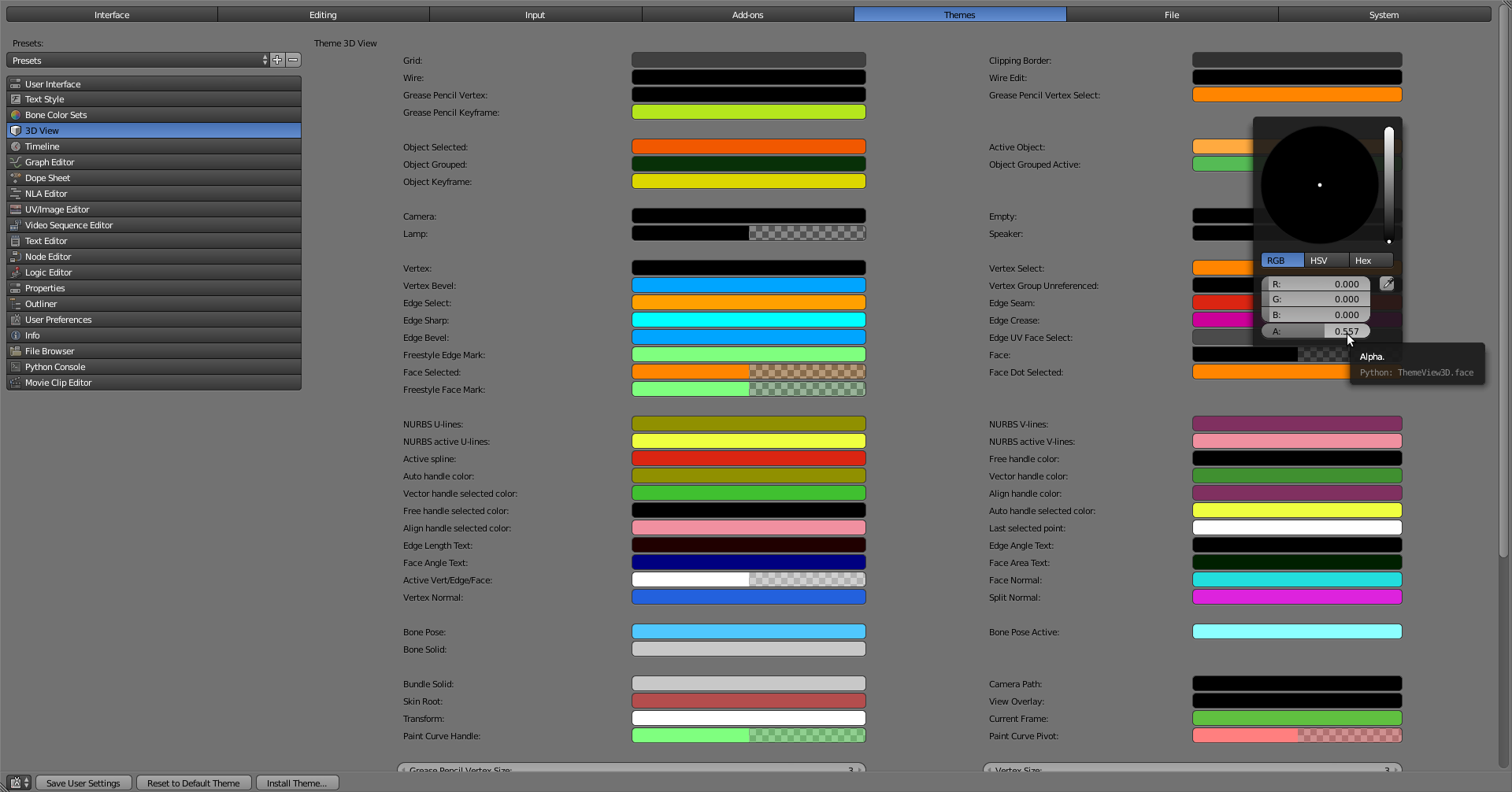

    If it’s pre-2.8, you can go to File > User Preferences:

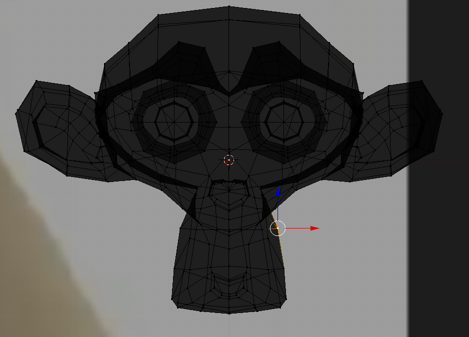

    and increase the Alpha like in above screenshot (by default it’s almost 0). This will have this effect:
    You can even change the color if you want.
    Mind you, this is the color for unselected Faces. Slightly below in the left column there is a Face Selected that is still transparant orange, but you can change that also.

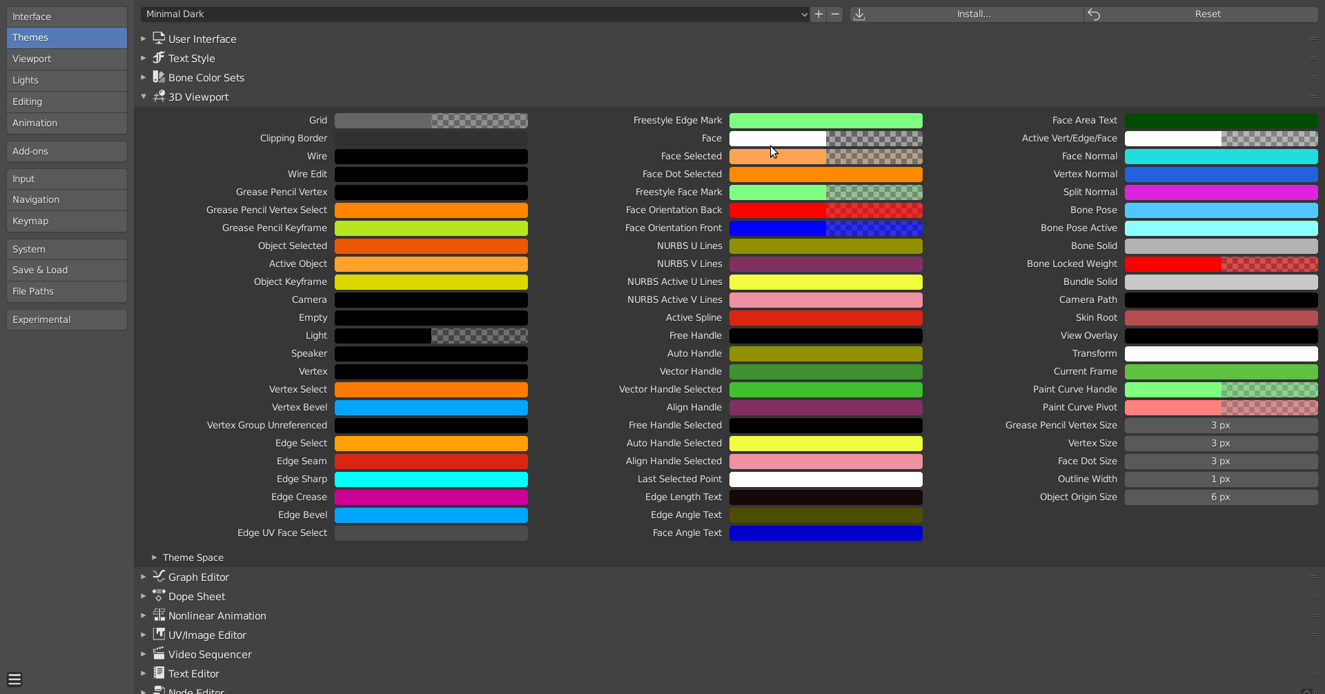

    In 2.8+
    You can also use Minimal Dark as Theme, that has darker Faces, but it’s good to know where to change it, in case you have other-colored Background Images.
