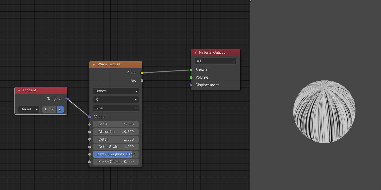

    If you are not able to analyze those procedural materials, just paint the textures (for the banana that is a lot easier anyway).
    To make those vertical lines he (in the link I provided) did something like this (I translated it to 2.83):
    And then you can distort that with a Noise Texture etc.
    Again, if you don’t get this, just paint…
