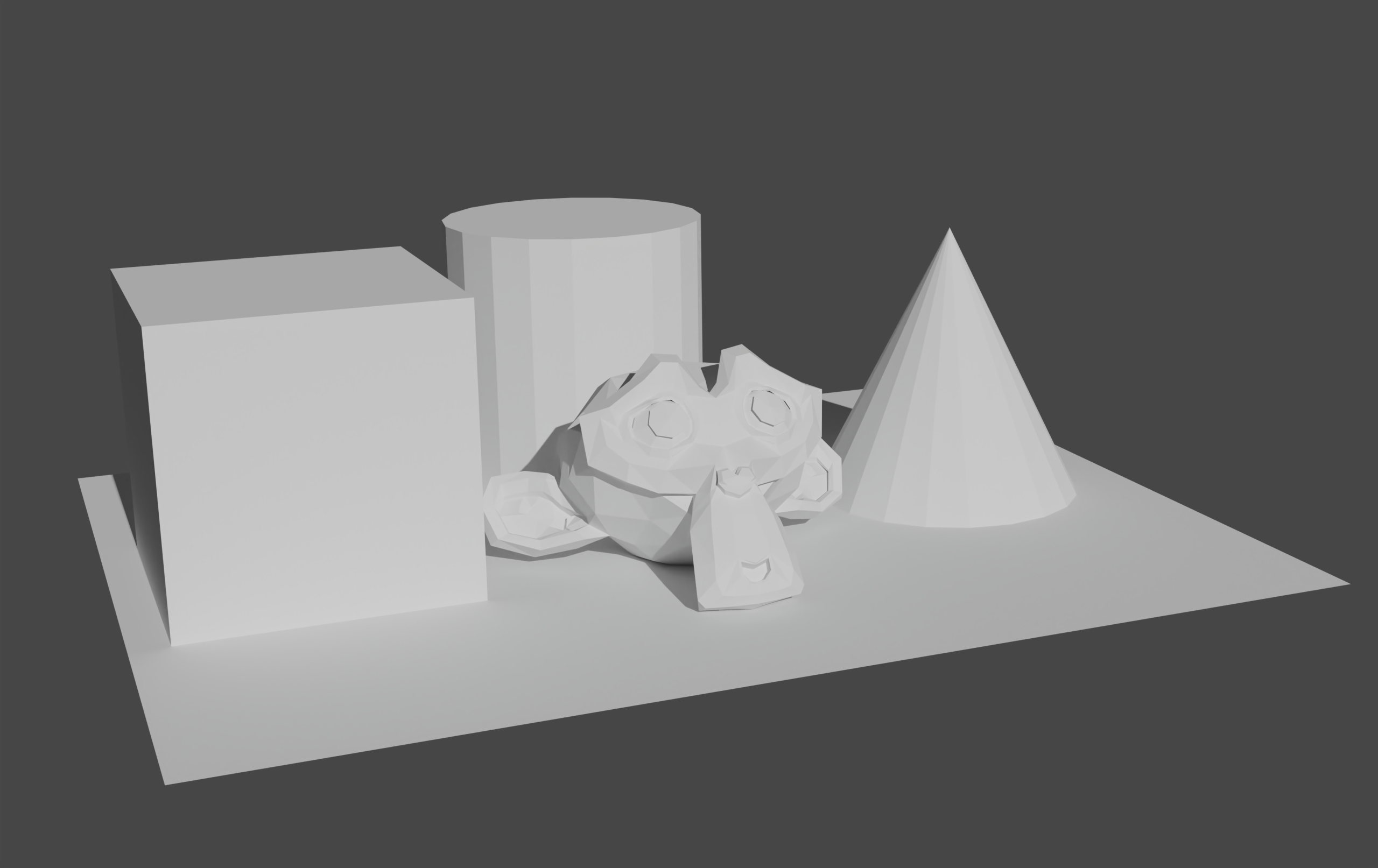

    I don’t know where other Blender users get the idea of using large sample sizes as 5,000 to render the final image. That’ll take half a day to finish and get the final result. I’m positive it’ll crash.

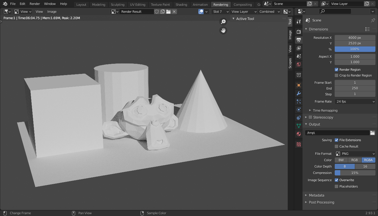

    Here’s my idea of 50 samples, dimensions of 4000 px (x) + 2520 px (y), and resolution 100% just at approximately 6 minutes. Very sharp and quick rendering with CPU. I did not use GPU at all. The image size is 5.99 megabytes when it’s saved on my computer.
    With denoise filter
