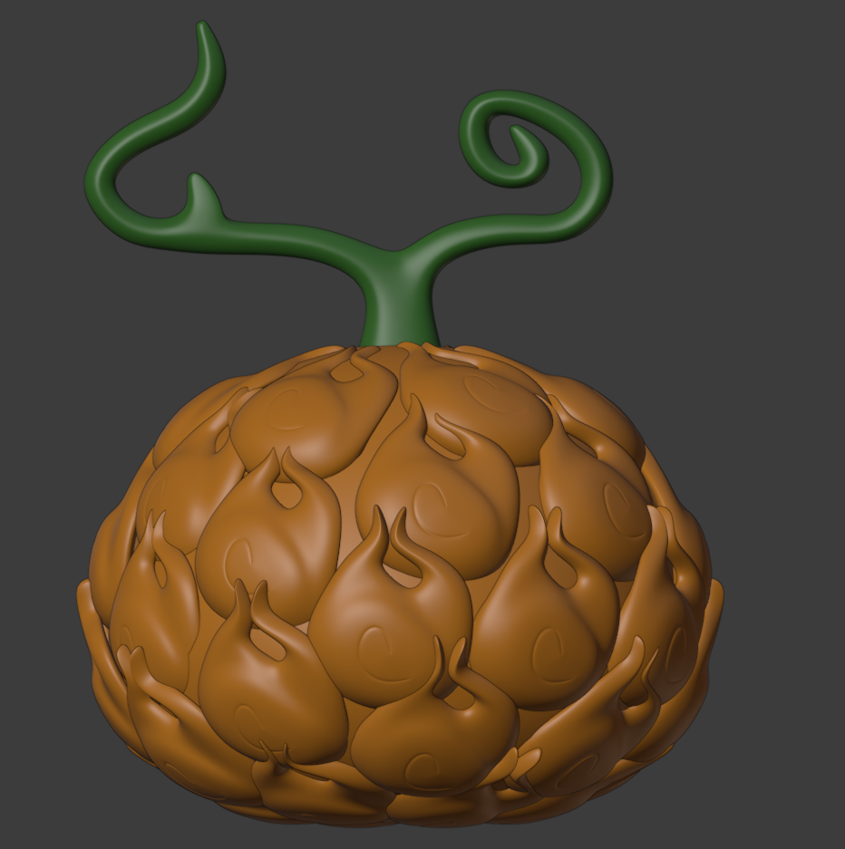

    So, this is my try:
    File is here.
    Notes (also included in the file):
    – Icosphere as Instancer:
    Duplication on instancer vertices
    (https://docs.blender.org/manual/en/latest/scene_layout/object/properties/instancing/verts.html)
    – edit the fruit “scales” only in
    “Edit Mode”: the local Y axis is aligned with the vertex normals of the instancer
    => “Tracking Axis” set to “+Y” (default)
    and “Up Axis” to “Z” (default)
    in the “Relations” panel
    of the “Properties Editor”
    – grooves made with edge beveling and inset (using CTRL for creation of depth);
    vertices connected with edges (using “J” key) in order to make it all quads
    – “Simple Deform” modifier in “Bend” mode to curve the fruit “scales”
    – UV-Sphere to fill the gaps between
    the fruit “scales”
    – both spheres slightly deformed; top and bottom vertex of the icosphere instancer dissovled
    (by joining the surrounding faces) in order to avoid unwanted instancing of fruit “scales”
    at these “sphere poles”.
    – further tweaking needed after application of the modifiers and making the duplicates real
