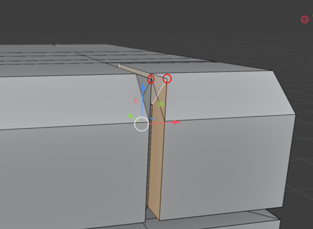

    Hi Chris @KOZ ,
    You can try, going into Vertex Select Mode and Delete these 2 corner Vertices:
    But that might leave you with some holes, that will need to be Filled again.
    If possible, it would be best to go back to before Beveling those Corners and Select everything with A and the M > Merge > By Distance.
