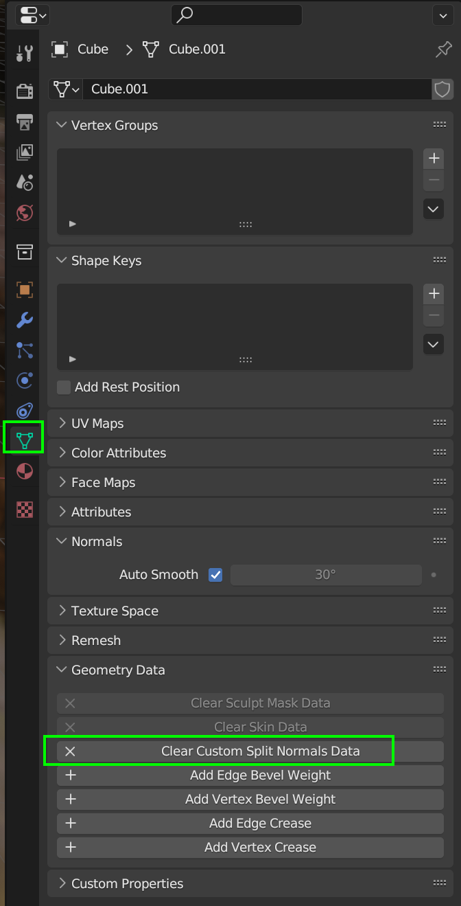

Hi Rich @CGDad ,
you might have Custom Normals on one or both of the Objects. You can clear them here:

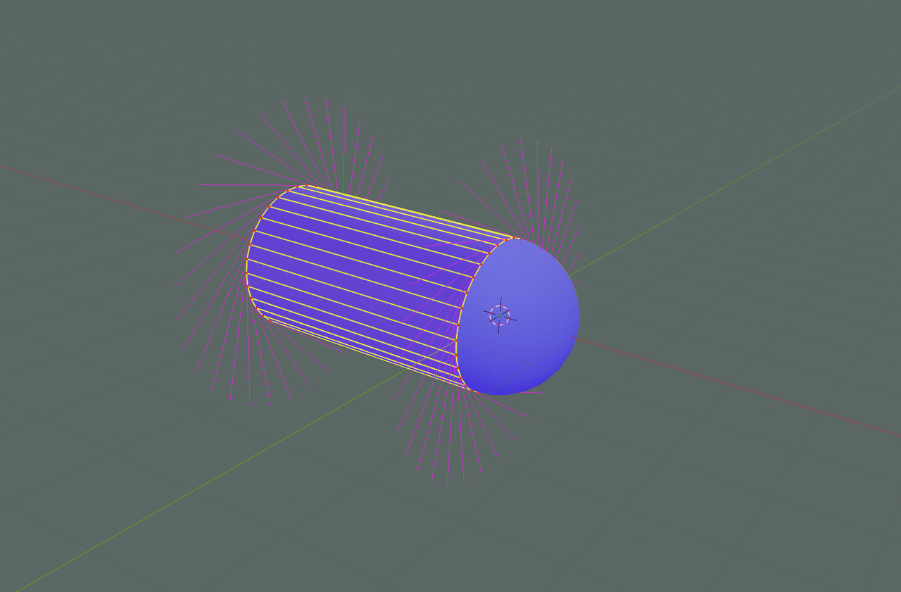

This might look something like this, the Normals are all facing outwards, but on the Cylinder, they are rotated:
