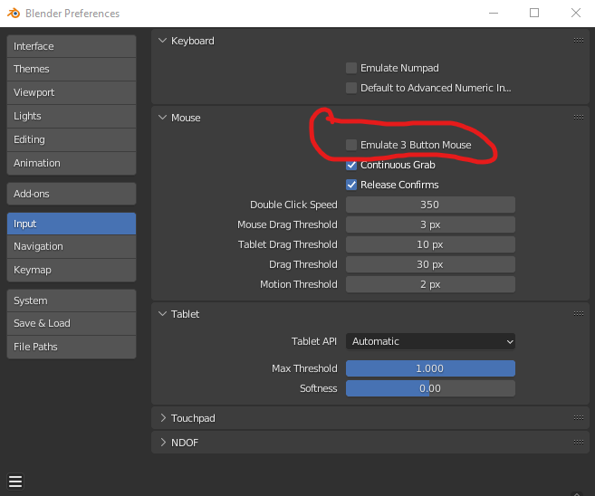

Most likely you have this option enabled?
That replaces the ALT key in favor of navigating in the viewport. If you have it enabled, try turning it off.
