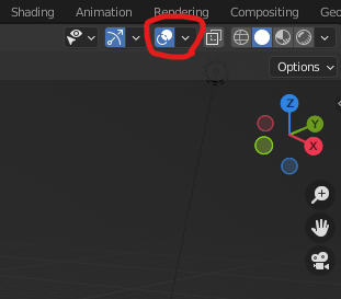

    Another thing that can be occurring is you have the Overlays turned off. Be sure you have those on:
