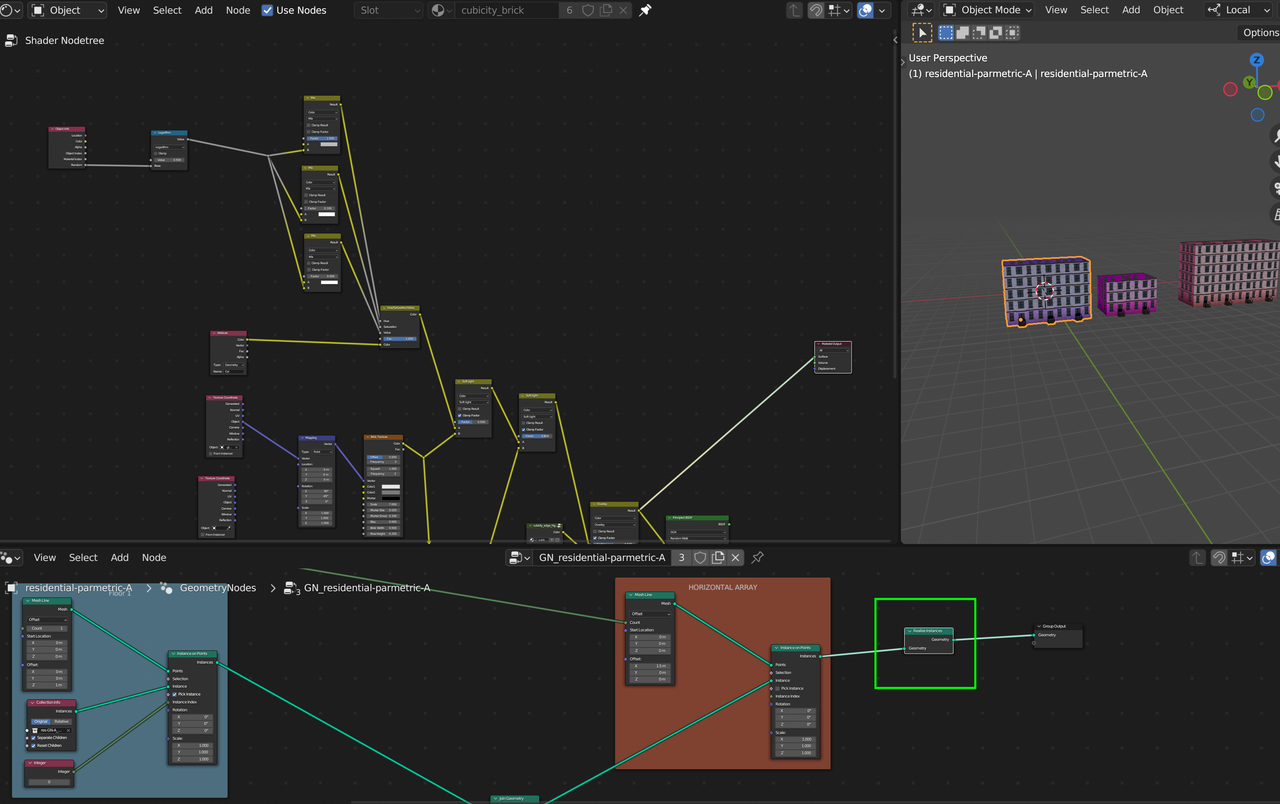

    Hey Karen,
    The main problem seems to be, that you don’t have a Realize Instances Node here:
    There is some more to be done, but if you go back to this Lesson:
    https://cgcookie.com/lessons/parametric-building-gradient-fix
    You might be able to solve this.
    If not, I can have another look tomorrow.
