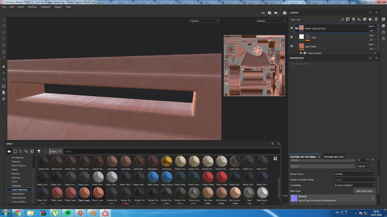

     I discovered that if I just export the low poly with smooth shading but without Auto-Smooth all the baking artifacts disappear BUT the edges have dark shading artifacts BUT only on metallic textures. Why? Does it have something to do with the Fresnel?

    Neither of these have metallic materials. The reason you’re noticing it more in the metal parts is because normal maps change the direction of reflection, and naturally a metallic surface will appear more reflective.
    Even if you bake it with smooth shading initially so that the edges aren’t messed up (which it looks like happened in the images below), you’ll end up with incorrect normals.
    You can see the problem pretty clearly in this picture:
    What should be flat surfaces have gradients of color across the normals, meaning that they will appear curved. The fresnel and material properties of metal make the incorrect curvature more obvious, but the issue is definitely still there with non-metallic materials as well. The more reflective the surface is, the more it will look incorrect. Flat things should look flat.
    It won’t be obvious in flat lighting, but if you change the lighting, try to add flat decals, or use any custom shader that works based on normal direction, it’ll look wrong, which is why it would not be acceptable practice in a game pipeline.
