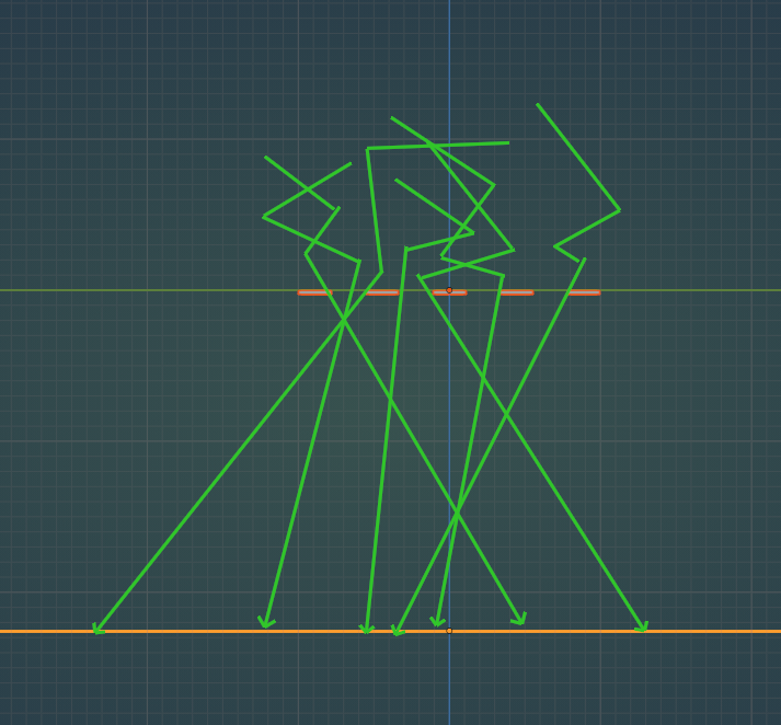

    Looks a lot better than you think @tanja53 !
    For the god rays, it is better to make a cube that fits in the room as the Volume. When you make the World a Volume, the light that comes in through the window is already scattered and enters the window from all directions, so the Plane with the cut outs doesn’t have the impact you’d like on the light…I hope that is a bit clear…
    Something like this (the light will also be scattered inside the room, but I didn’t draw that):
