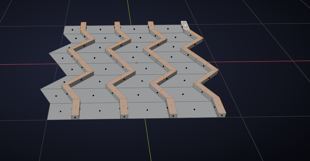

    Hi Sanne, I’d probably start with a Plane and make some edge loops and shift a few, something like this:

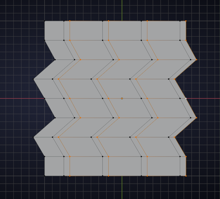

    Move the selected edge loops along the X-axis:

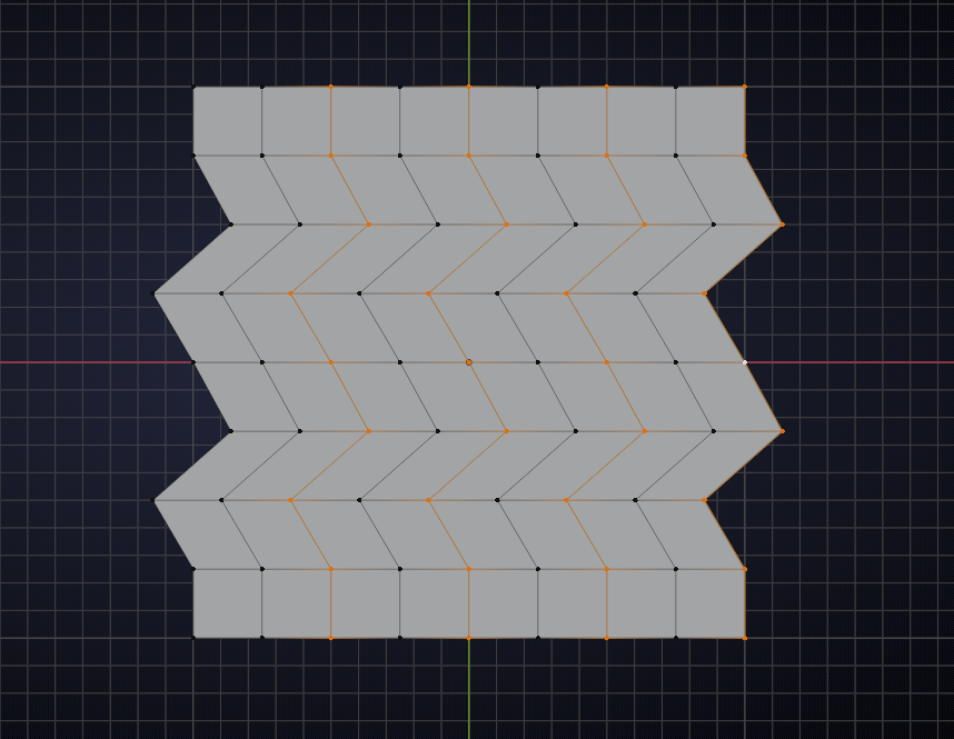

    and extrude the treads:
    You’ have to make a few of those edge a bit longer in the first screenshot, but that doesn’t change the principle.
    And they are guaranteed to have equal thickness along the X- and Z-axes this way!
