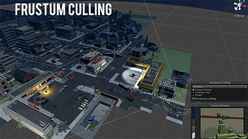

    By setting the AO distance so high, it’s essentially telling Eevee that an object should be occluded by everything within 80 meters of it. The reason the camera’s closeness had an effect is that screen space AO can’t take anything behind or outside of the camera into account, so the closer something was to the camera the fewer things Eevee would see around it to occlude it. Check out this gif and notice how, the closer something is to the camera, the less an engine like Eevee will naturally see around it:
    Hope that helps!
