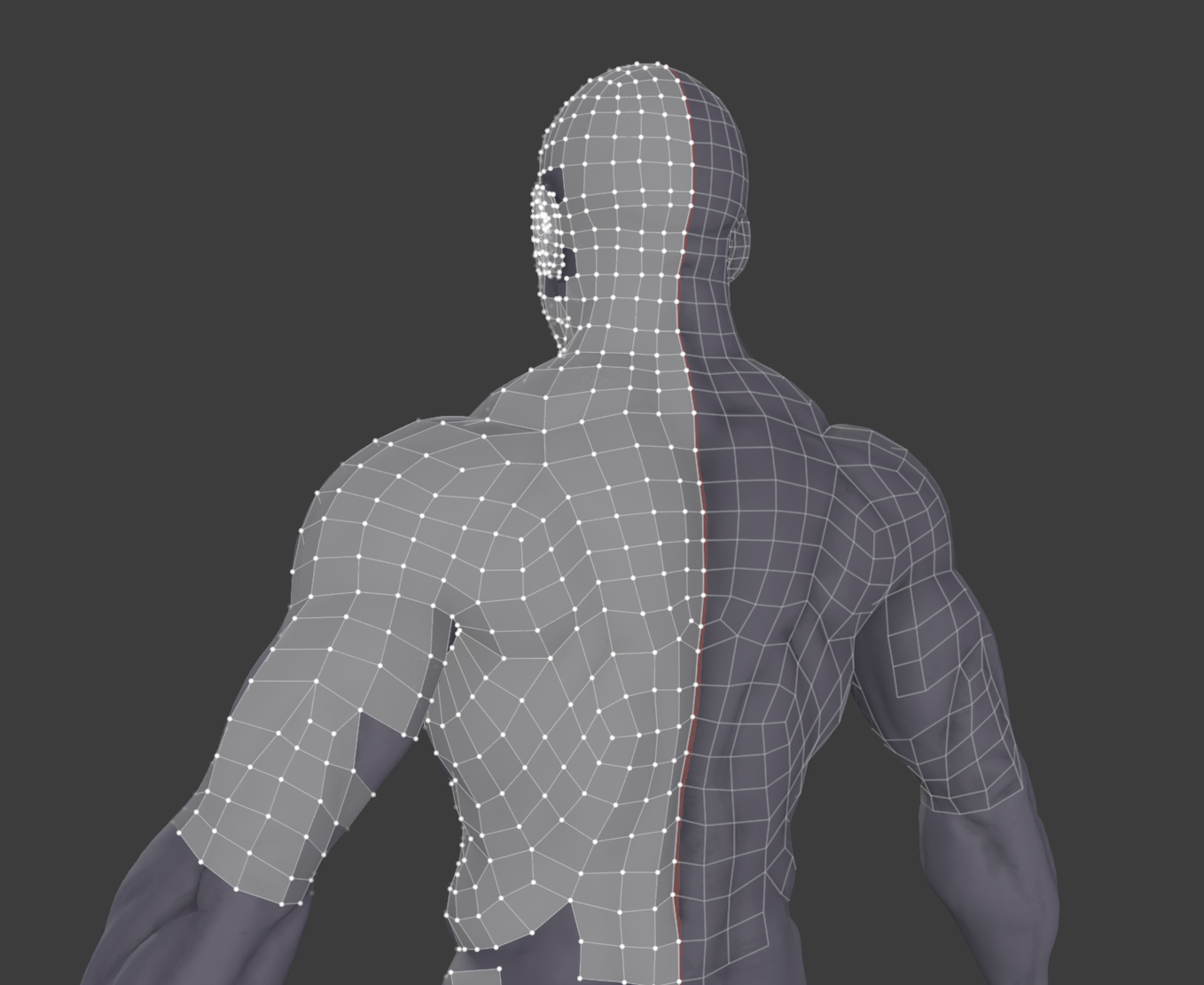

    Here’s an example from when I was testing out RetopoFlow:
    It’s definitely not perfect, so you wouldn’t want to follow it loop for loop, but in general that amount of density is as high as you would probably want to go.
    Notice how it’s just enough detail for the subdiv modifier to crisp up without drastically changing the shapes.
    If you’re just doing this for practice, I would recommend that amount of detail or even much less.
