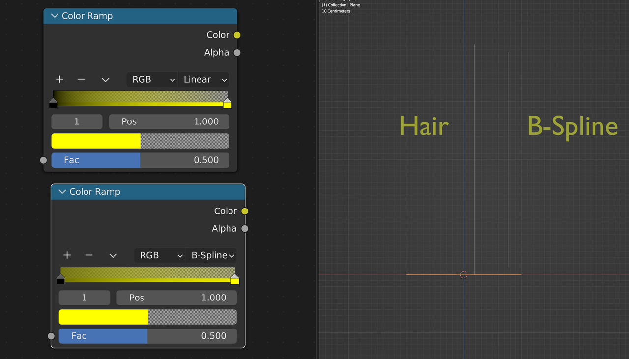

    Well found Brad!
    I didn’t know that; as NURBS are (weighted/ Non-Uniform)) B-Splines and B-Splines in Blender by default do not reach the end Control Points:
    B-Spline.png,
    I just accepted it. Well, to be honest, I never use NURBS (they are really under-developed in Blender).

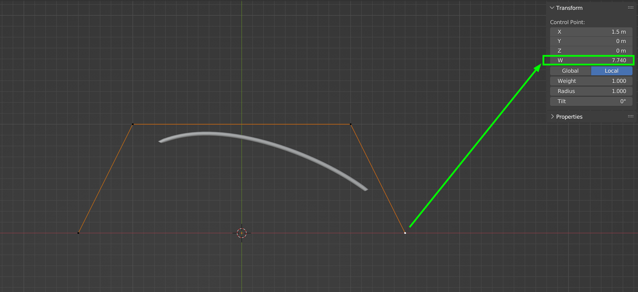

    But if you want to change the Weight of a  Control Point, that is done with the W value (not with the Weight (that is the Soft Body Goal Weight)):
